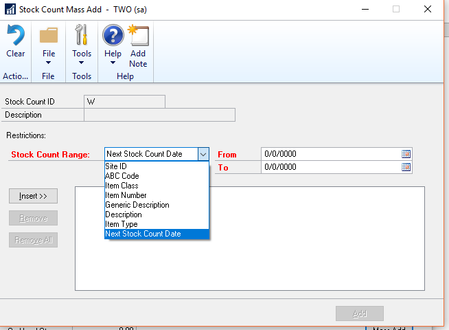

      By off-the-shelf do you mean that the inventory items/quantities are not in GP at all?Ā  If the items are in GP, do you have a Location for the barn or are the items just mixed in with the other stock?
      My train of thought is if the items are in GP and in their own site, then you can use the native Stock Count functionality to print your reports.Ā  You would just build a Stock Count for the Barn location and when you print the stock count report, check the box to include serial/lot numbers.
      If they aren’t in their own location, then there are a couple of other fields in GP that you can use to restrict/select items for stock counts and maybe you could use one of those fields to build a stock count schedule for just the Barn items.
      Hope that gives you a starting point.
