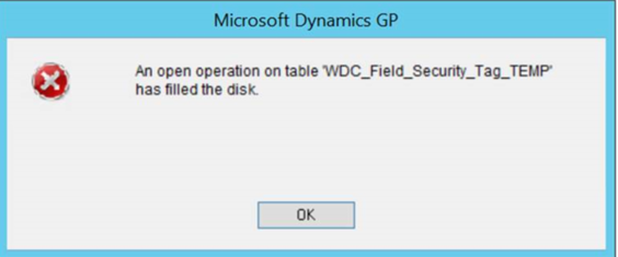

      We have concurrent licenses for 98 GP users and we have about 78 GP logins today.
      We have one user who can log into GP but immediately gets the following screen shot.
      We have searched for temp files that could be causing this but I am searching for more resolutions in case anyone has a suggestion.
      Any assistance would be appreciated!
      Thanks, Steve
      Screenshot of GP error

      Their local workstation’s drive that holds the %TEMP% folder is full.
      Simples
      David
      FYI: This is a memory table (stored as a ctree table in the local workstation’s %TEMP% folder) used by Field Level Security (written by me) to store trigger tags.Ā  GP Power Tools and a number of other products that use memory tables or local temporary tables would have similar issues when the local hard disk is full.
