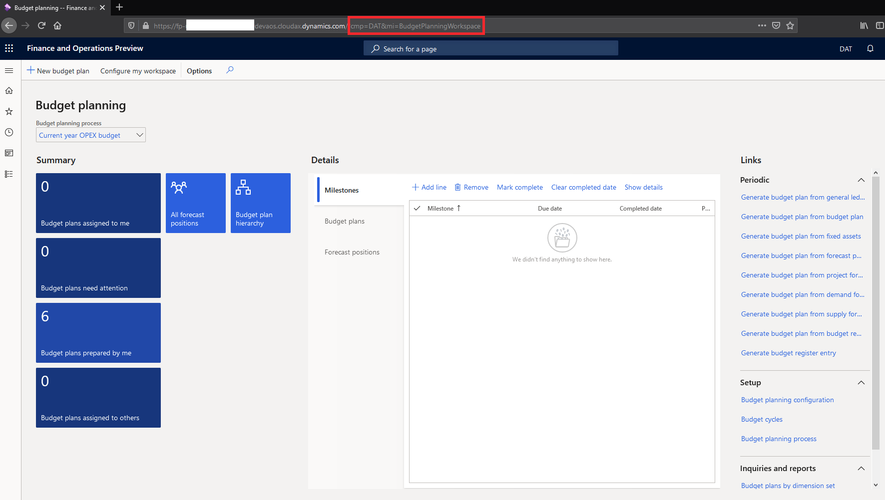

      I don’t see a screenshot on your previous post but to give a little background on how D365FO works, when a user goes to a particular page/form within D365FO that particular form is tied to a menu item display securable object. This is the object that controls access to the workspace itself. You can find out which menu item display is controlling a particular page by doing one of the following:
      1) Look in the URL
      The URL of the page you are on will show the company and menu item display controlling that particular page.
      The value after cmp is the Company, in this case the DAT company
      The value after mi is the menu item display, in this case the BudgetPlanningWorkspace, so for a user to have access to this page they would need to be assigned access to the BudgetPlanningWorkspace menu item display

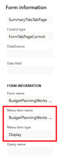

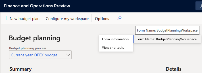

      2) Right click -> form information
      By right clickingĀ  on the form itself and going to Form Information -> Form Name, a dialog box will appear at the right hand side of the screen showing additional information about the particular form you are on (you will need to be assigned SysAdmin or Security Admin roles to do this)
      This process is useful if an action is performed on the main screen that causes another form to overlay on top of the original and you need to get information about it.
