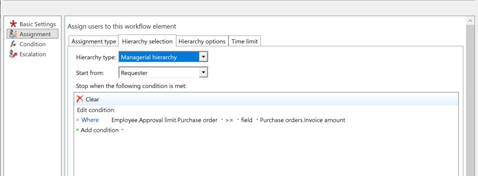

    • Johnny Bendtsen
      April 28, 2020 at 4:59 PM
      Hi Travis
      Did you ever find out why it always stops one level up?????? I have exactly the same problem at one of my customers.
      I have setup signing limits (approval limits) and attached job rules to those limit lines. I have made sute the employee is created in the legal entity and that a job role is related to the employees (approver)….No matter what I do it still goes one level up only…I have created the following stop rule – and I expected it to stop search when an employee in the hierarchy has an approval limits that is higher than the purchase order total…But it doesn’t.Ā
