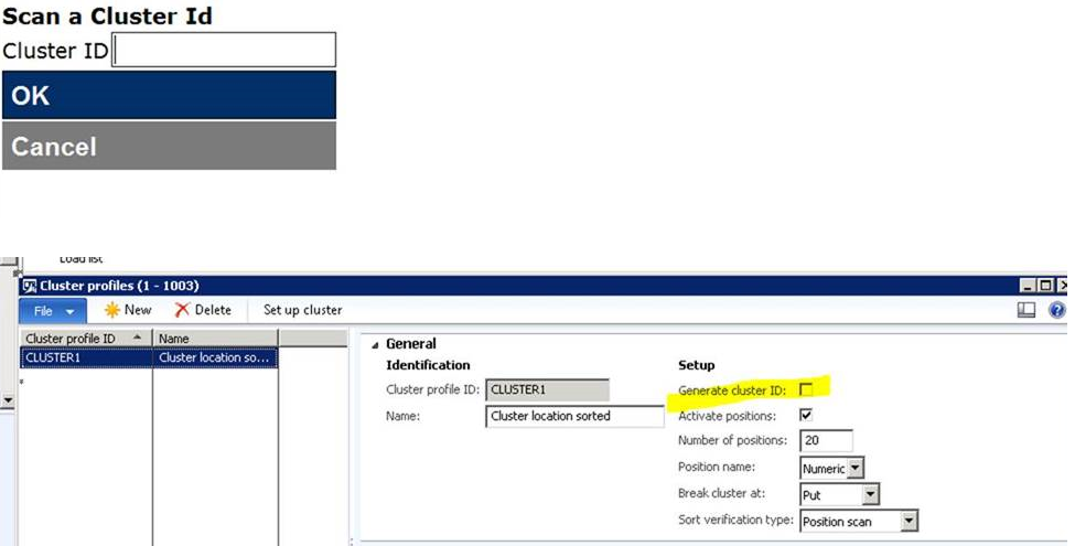

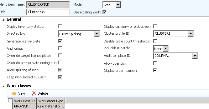

      I like the picking user interface of cluster picking where we can scan one LP for and put the quantity in multiple boxes representing different work/production orders. But there seems to be no way to pick up an existing cluster using mobile menu items? The only way to work with clusters is to create and execute directed by Cluster picking.  Anyone who has any other experience?
      ***’Edit****
      Found a solution. If you use a cluster picking profile with Generate cluster ID un-checked you get to scan/enter cluster id. Now you can pick up a cluster created by another user or customization.
