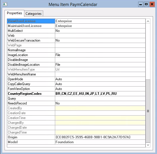

    • Steve Latta
      August 6, 2018 at 4:54 PM
      It seems I’m not the first to have this problem. Payment calendars are only available for certain countries, and United States is not among them.

    • Ludwig Reinhard
      August 7, 2018 at 12:56 AM
      Hello Steve,
      The thing with the country limiatation seems right for AX2012.
      In D365FO payment calendars seem to be available for all countries.
      Probably talk with a dev colleague to assess whether you can make this feature generally available.
      There do not seem to be too many country-restrictions in place on the underlying tables and methods and it seems feasible to make payment calendars available also for your country environment.
