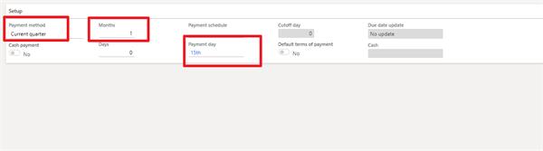

    • Andrew Xu
      November 26, 2019 at 1:48 PM
      Hi Debbie,
      You should be able to do this by setting up a payment day and term of payment, here’re the screenshots of the setup,
      1. Payment day
      2. Term of payment
      After setting them up, use the new term of payment on your invoice, you’ll see the due date automatically scheduled at the 15th of the first month of next quarter.

    • Debbie Parod
      November 26, 2019 at 2:43 PM
      ?Thank you for your response Andrew.Ā  Unfortunately I was not able to clearly see your second screen shot and the terms of payment setup you are recommending.
      Debbie Parod
      Montana Silversmiths
      Columbus MT
    • Andrew Xu
      November 26, 2019 at 2:50 PM
      Is this better?
      Payment method: Current Quater
      Months: 1
      Payment day: 15th (created in 1st step)

    • Debbie Parod
      November 26, 2019 at 2:59 PM
      ?Got it…
