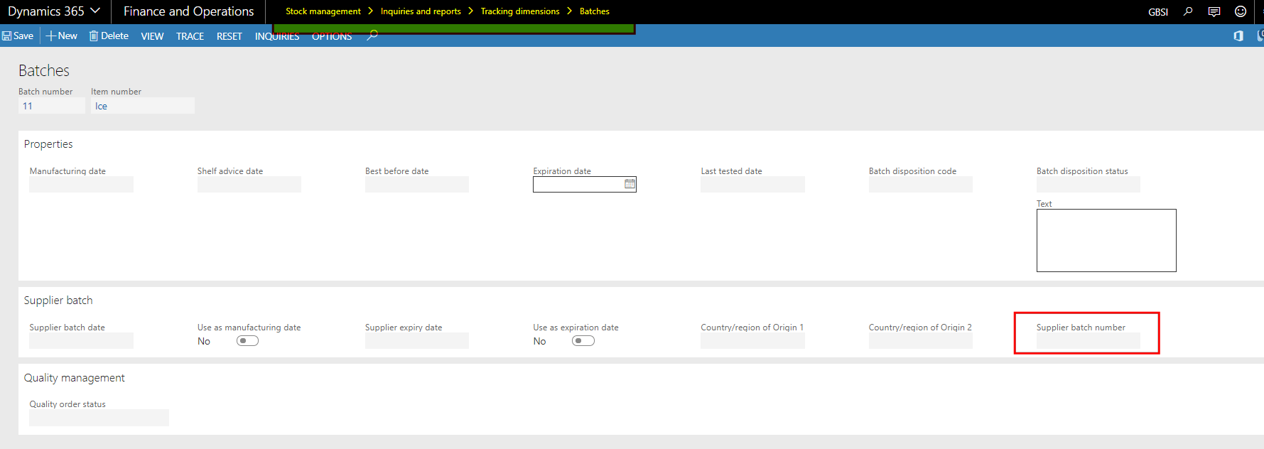

    • Michal Mydlikowski
      February 7, 2019 at 4:10 AM
      Hi Travis,
      yes, there is a specific field where you can capture this information and even more details that could come from your supplier.Ā
      You can find it in Batches form as shown below:

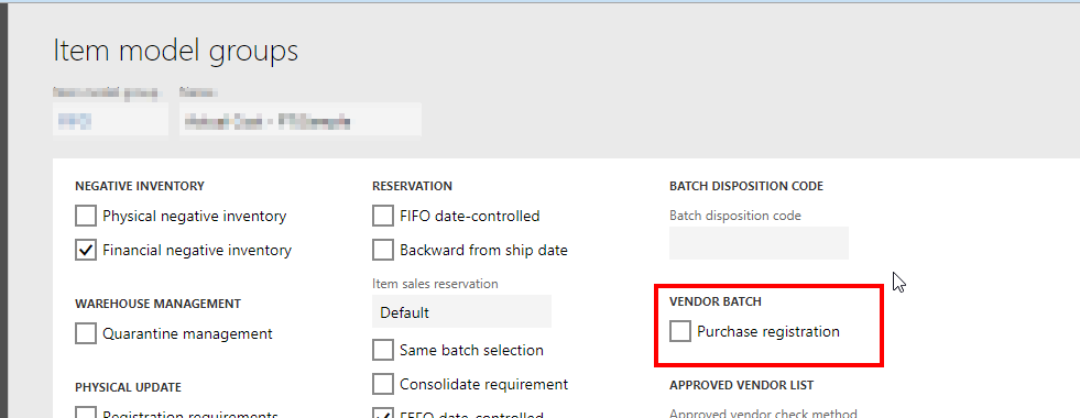

    • Andrew Lencsak
      February 7, 2019 at 7:45 AM
      I do believe if you want to use the field Michal mentions, and record the vendor batch number when doing receiving, you need the below checkbox enabled on the Item model group of the item:
      This would prompt you to enter the vendor batch during Purchase order registration.
