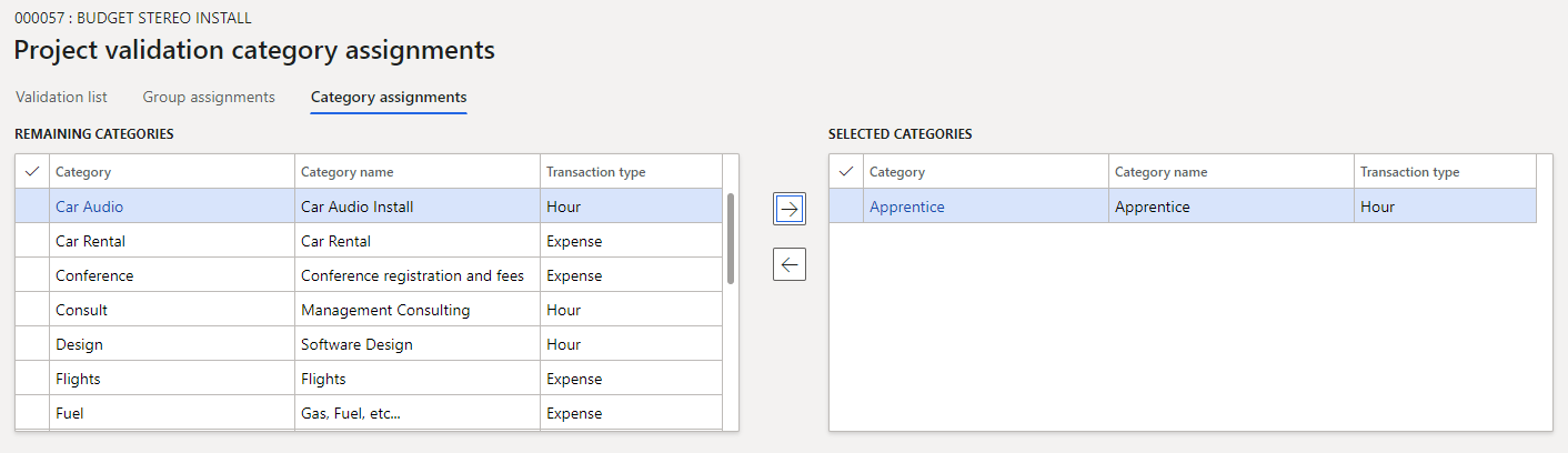

      Option 2: Assign the category to the project.Ā
      • Open the project and navigate to the Plan task bar at the top of the screen. Click the Assign categories option.
      • Click on the Category Assignments tab. In the Remaining Categories list, select the categories you want to use on this project.Ā  Click the arrow pointing to the right to move the categories to the Selected Categories list.Ā  You will now be allowed to use the Selected Categories on that project.Ā

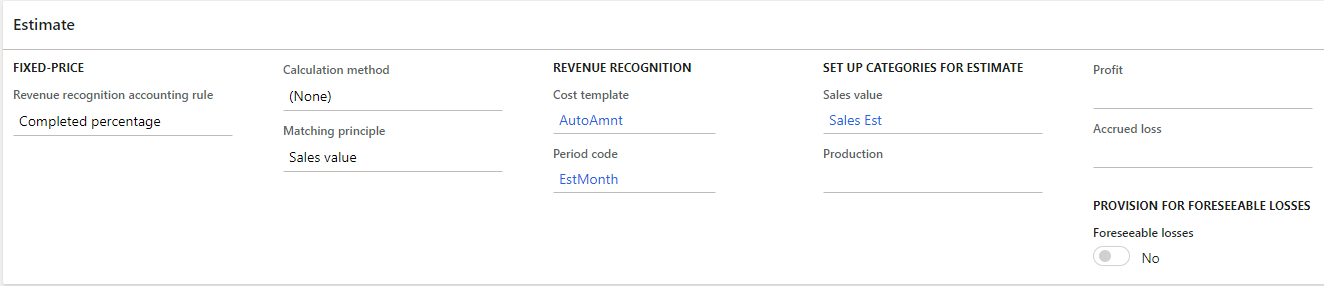

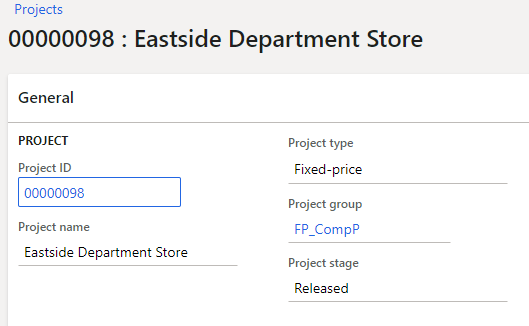

      It might be related to the Project Group assigned to the Project.Ā  Open the project and locate the Project Group on the General tab.
      Open the project group from the project.
      Go the Estimate tab on the Project Group screen.

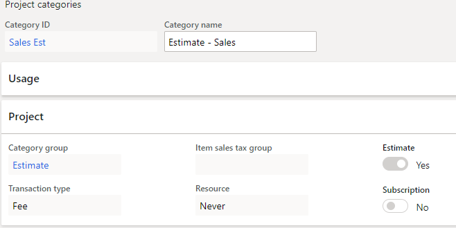

      Check the Set Up Categories for Estimate section.Ā  I think your issue may be related to the settings here.Ā  Do you have anything setup in these fields?Ā  If not, then this is most likely the cause of your error message.Ā Ā
      If you do have values in one or more of these fields, then click on the values and check the settings.Ā Ā
      This is how my example is setup.Ā  Note that Estimate is set to Yes.Ā Ā
      I’m not positive is this is the cause of your error but it’s one possibility. I hope this helps.
