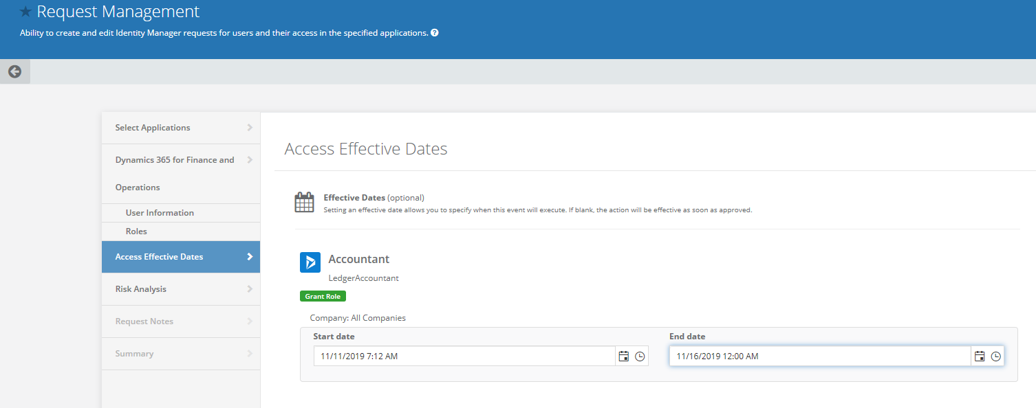

      As far as I know, there is no way to do this natively within the application. However, theĀ Identity Manager tool from FastpathĀ does exactly what you are asking for with its ‘access effective dates’.
      For example, if I wanted to specify when a user should be granted a particular role I can set the start date and end date of the access. And once the request is approved, the user will be automatically granted the role on the start date and revoked the role on the end date (which can be set down to the minute).
