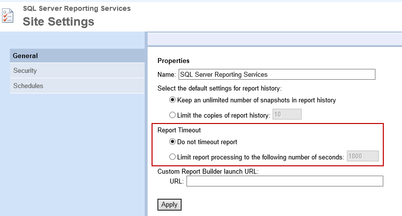

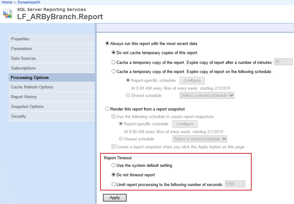

      Due to monthend, today we have an urgent situation where a much-needed report is timing out, and we’re unable to make the necessary pre-process changes without having to do a code release to our PRD environment.Ā  Currently I have the Report Server Site Settings and the report’s Processing Options set to “Do not timeout report”.
      Report processing options
      The report still times out after 10 minutes.

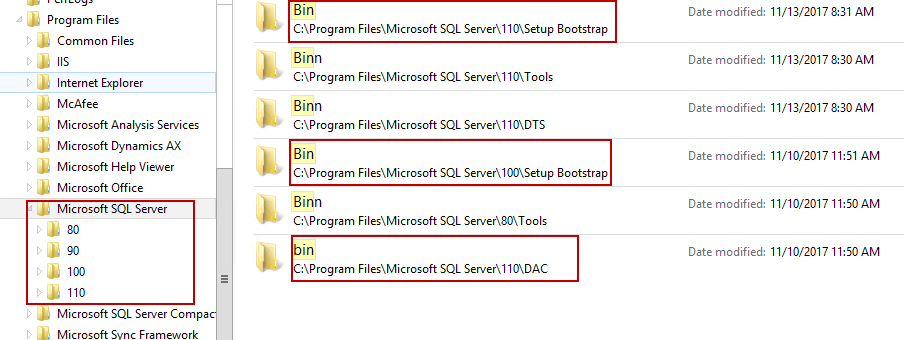

      ?Ā  Thanks for the suggestion.Ā  I would like to try that in one of our development or test environments first.Ā  The SQL Server folder structure on those servers looks like this:
      Ā Ā Ā Ā Ā Ā Ā Ā Ā  SQL Server folder structure on DEV & TEST servers
      There are 3 “bin” subfolders within the folder structure.Ā  Should I put the .AXC file in the bottom bin folder?

      , it looks like you don’t have the SSRS subfolders on that server.Ā  The custom AXC file needs to reside in the ReportServerBin folder of the SSRS instance used for your AX environment.
