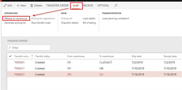

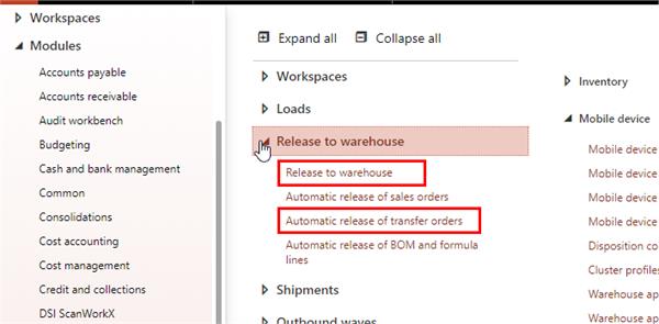

    • Andrew Lencsak
      August 2, 2019 at 11:56 AM
      Hi Reza,
      There’s 3 ways to release the order, manually from the Transfer order form, from the menu Automatic Release of Transfer orders in Warehouse Management, or manually from the Release to warehouse form in Warehouse Management.
      The prerequisite is the same that inventory has to be available to create the load and work but it is not needed to create the shipment and the wave. Do you have access to the Dynamics learning portal? It has good information with videos and learning materials on warehouse management:
