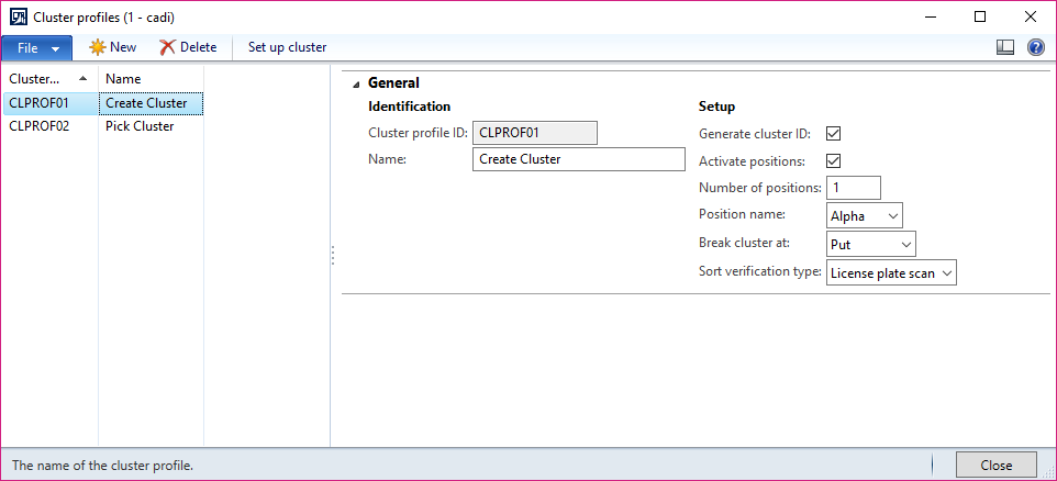

      We are sorting by sort code in the Edit query of our work template, however when an item is split into different locations it will visit all locations for ItemA (using sort code), then may revisit the same locations for ItemB (again using sort code) and so on. This means that any given location can be visited multiple times (work lines are first sorted by item and then by location even though the work template only contains the sort code).Ā

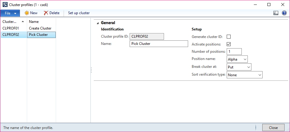

    • Tania Commisso
      November 14, 2017 at 12:31 PM
      Yes, we tried cluster picking but it’s still following the order of the work lines (sorted by item first and then sort code).
      Can you see anything wrong with our cluster setup? BTW, we also tried adding the sort code in the Set up Cluster/Cluster sorting
