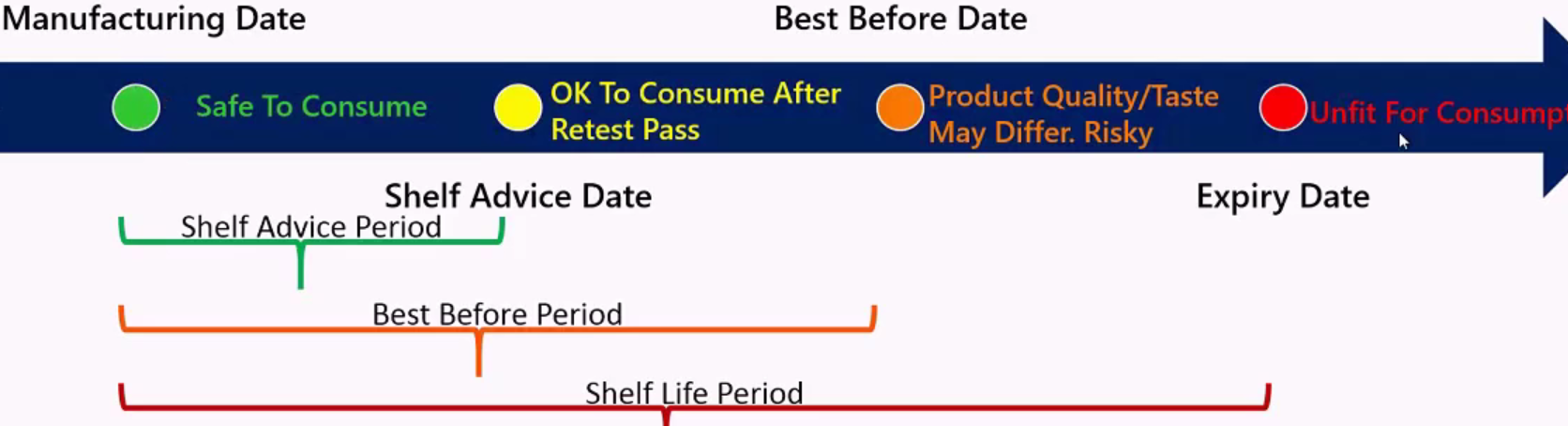

      Ā  I always go back to this image for understanding the batch dates:
      I’m hearing a mix of things in your question.Ā
      How is your item model group set up for these items?Ā  Are you using FEFO reservation logic, and if so is it based on Expiration Date or Best Before Date? It will affect the required fields on the released product, which will in turn affect how batch dates are initialized.Ā Ā
