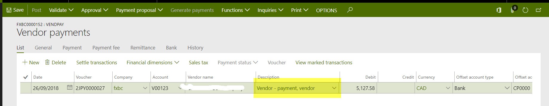

    • Zvika Rimalt
      September 27, 2018 at 1:59 AM
      I am not sure what we are doing differently, but when I:
      1. Run payment proposal in the AP payment journals, all journal lines are populated with the default description from Vendor Payment – Vendor.
      2. Later, when I post this journal, the description from the journal (as is always the case, with all journals) get copied into the GL transaction (and this description also gets stamped on the vendor transactions)
      Can you try create your journals the “standard” way (your “option 1”) and see if you still don’t manage to get descriptions populated for you?
