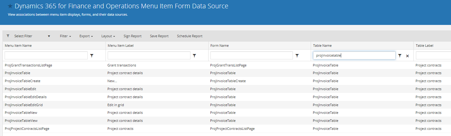

      For D365FO, there is now a direct connection between a menu items access and the access that a user has to the data sources that are tied to it via the form. So you would need to go to the menu item level to look for difference in access. At Fastpath, we have developed a report to show the associations between menu item -> form -> data source which is how I was able to generate this below. But as you can see any of those menu items could give the user access to the ProjInvoiceTable.Ā
