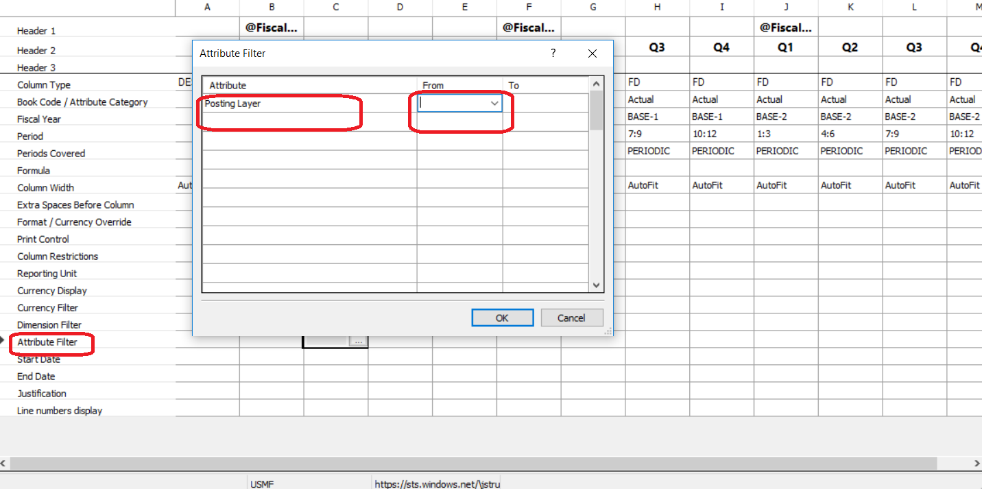

      ?How can I report on multiple layers in the D365 Finance and Operations Management Reporter?Ā  For example, we have periods 1-12 recorded in the current layer, but abnormal year-end adjustments required for GAAP purposes are recorded in custom layer 1.Ā  I need to report on the combined current and custom layer 1 for year-end financial reporting and I’m struggling on how to do this.

      ?Michelle,
      In the Column Definition, there is a row for ‘Attribute Filter’
      One of the options there is for you to choose a Posting Layer.
      You can use a different Poster layer in separate columns and add them together or in the one Posting Layer, you can combine Posting layers:
