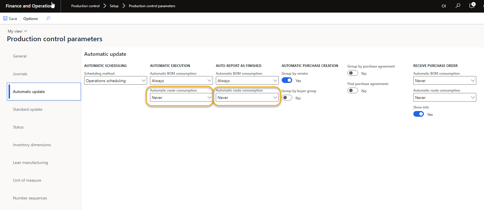

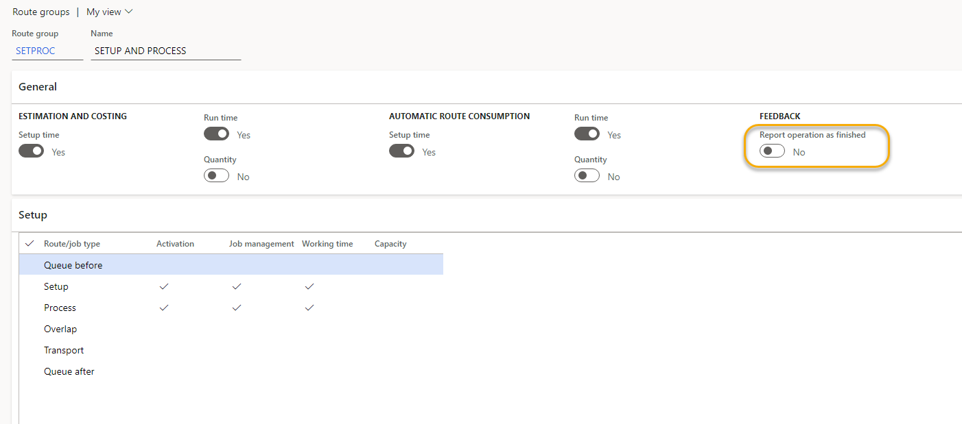

      Have you tried setting the Feedback option to “No” on the route group?Ā  I believe this controls whether the ‘End job’ box needs to be marked on route card transactions prior to RAF.
      You may also want to play with the settings on the Production control parameters here.Ā  This may only apply to when you skip the process step (i.e. going from Scheduled to Ended directly).

      Thanks for the response. I had already tried both of your suggestions but can’t RAF complete without posting a route card journal for the last operation. Our time recording/MES is outside D365 and because the approval process is not real time, we can’t create our route journals before the production orders are completed.

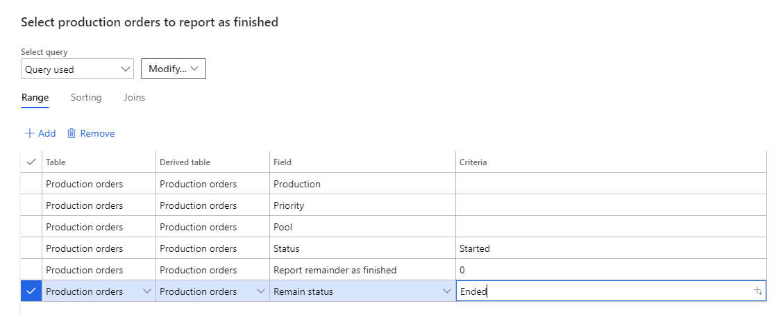

      It sounds like you want to get the production order to a reported as finished status, but is that necessary?Ā  Ā You just want to create inventory of the finished good before posting the route card journal from the sounds of it.Ā Ā
      You can post a Report as Finished journal without posting route card journals / doing anything route related.Ā  This would leave your production order in a “Started” status, report remainder as finished quantity would be 0 assuming your RAF was for the full production quantity.Ā Ā

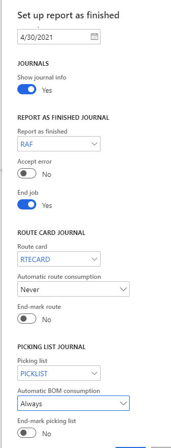

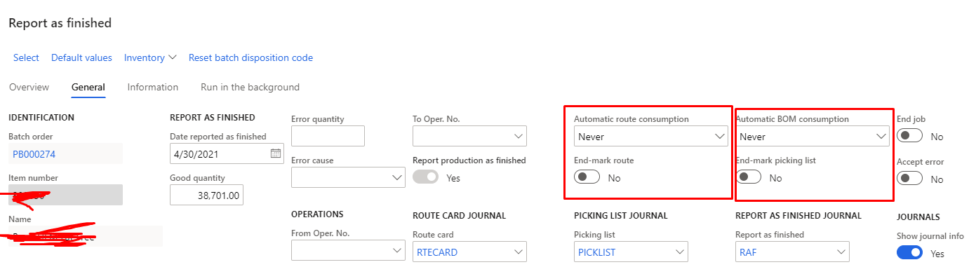

      IE Post a RAF like this:

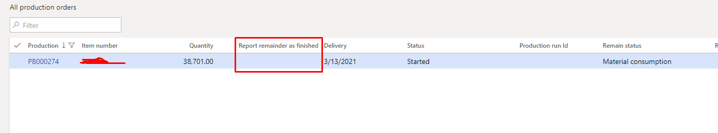

      And now you have a production order that looks like this, you’ve received in inventory all 38,701:

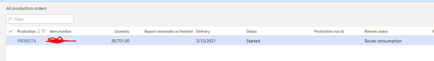

      Once all your material is consumed via picking list / end marking consumption, you’ll be in a remain status of route consumption:
      Once you post your route card journals you’re in a remain status of “Ended”Ā
      Have a periodic job running (Production Control -> Periodic-> Production order status update -> report as finished for all production orders in status Started, with report remainder as finished qty = 0, with remain status at Ended.Ā Ā
      Default values should be no flushing, no route consumption, end job = yes, accept error = no:

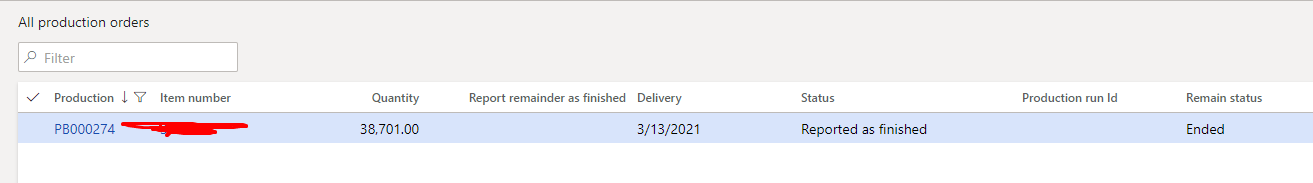

      Production order is now in status Reported as Finished:
