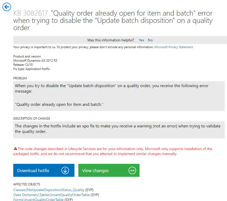

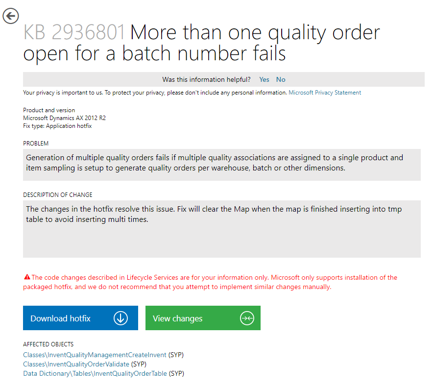

      3.) Does your test group have the quality order trying to update batch disposition?
      4.) What does your quality association look like? Ā Ā
      I’m guessing Jeff’s comment is related to the Item Sampling -> Per Tracking Dimension -> Batch flag. Ā But that will just split the existing transaction into multiple quality orders if there are multiple batches on the transaction (IE a production order RAF making 5 different batch numbers). Ā I’m not aware of one flag that restricts quality order creation to one per batch / item number. Ā You have to configure multiple things to cause that outcome. Ā
      Also, while looking at something else I came across a couple hotfixes you may want to investigate. Ā
