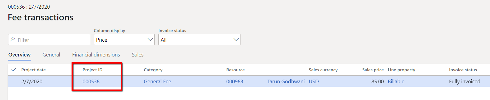

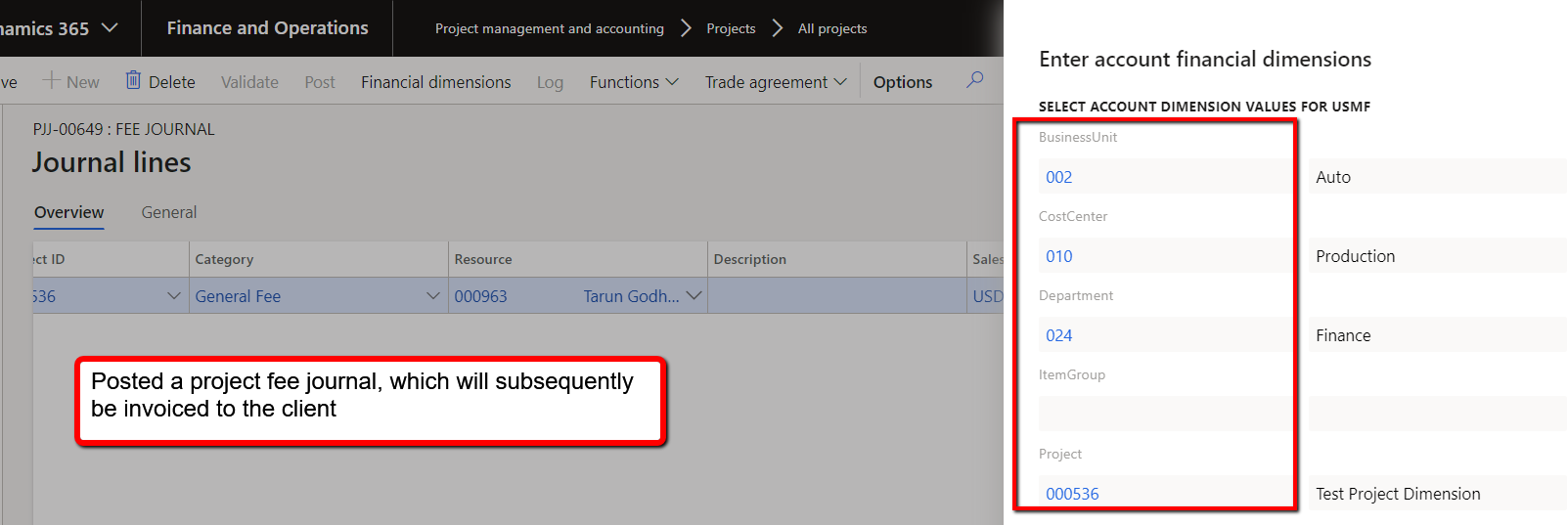

      All – I’d appreciate your inputs to the following issue.
      Backgroud:

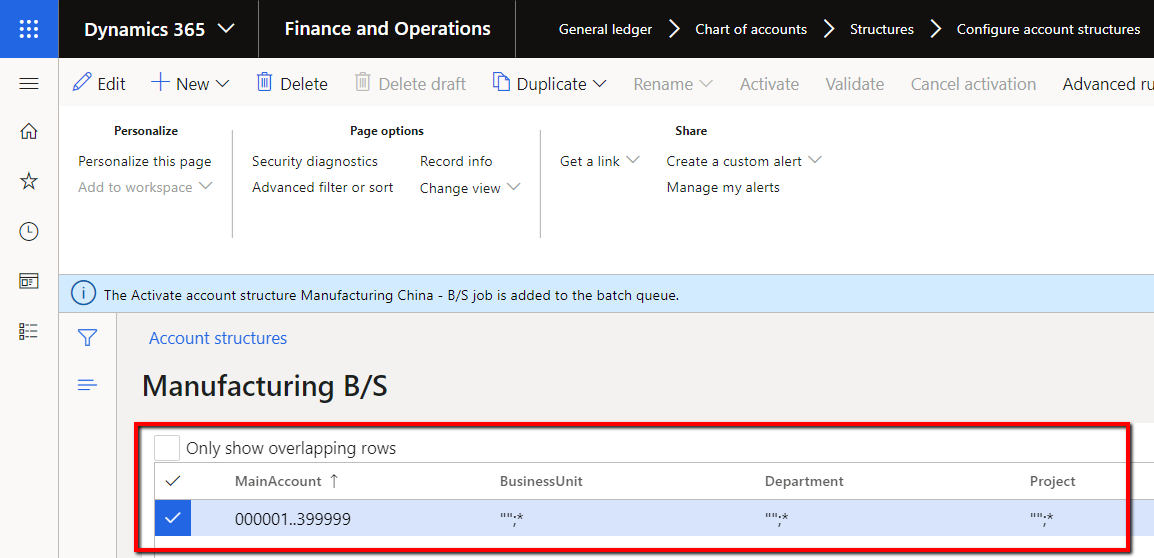

      • Customer invoices are posted via the Project Management and Accounting module
      • Project has been set up as a Financial Dimension
      • Project Dimension has been added as a segment to the Account structure (refer to 1st screenshot below)

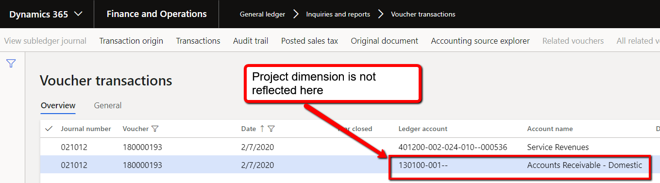

      Issue
      • When posting a Project Invoice, the Project dimension does not show up as a segment against the AR summary Account (within the voucher). Refer to the last screenshot.
      Question
      • Can I know what needs to be configured in order to stamp the Project dimension against the AR summary account? I’m hoping that it is a case where I have missed a setup rather than this being standard functionality.

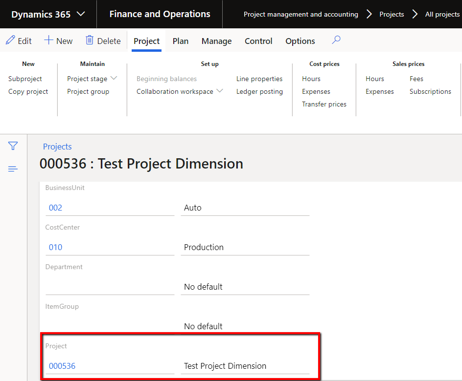

    • Tarun Godhwani
      February 10, 2020 at 1:23 PM
      Hi Esther,
      Thanks for replying back! To answer your question, yes, the financial dimensions are set up as defaults against the project in question. I have attached a screenshot below.

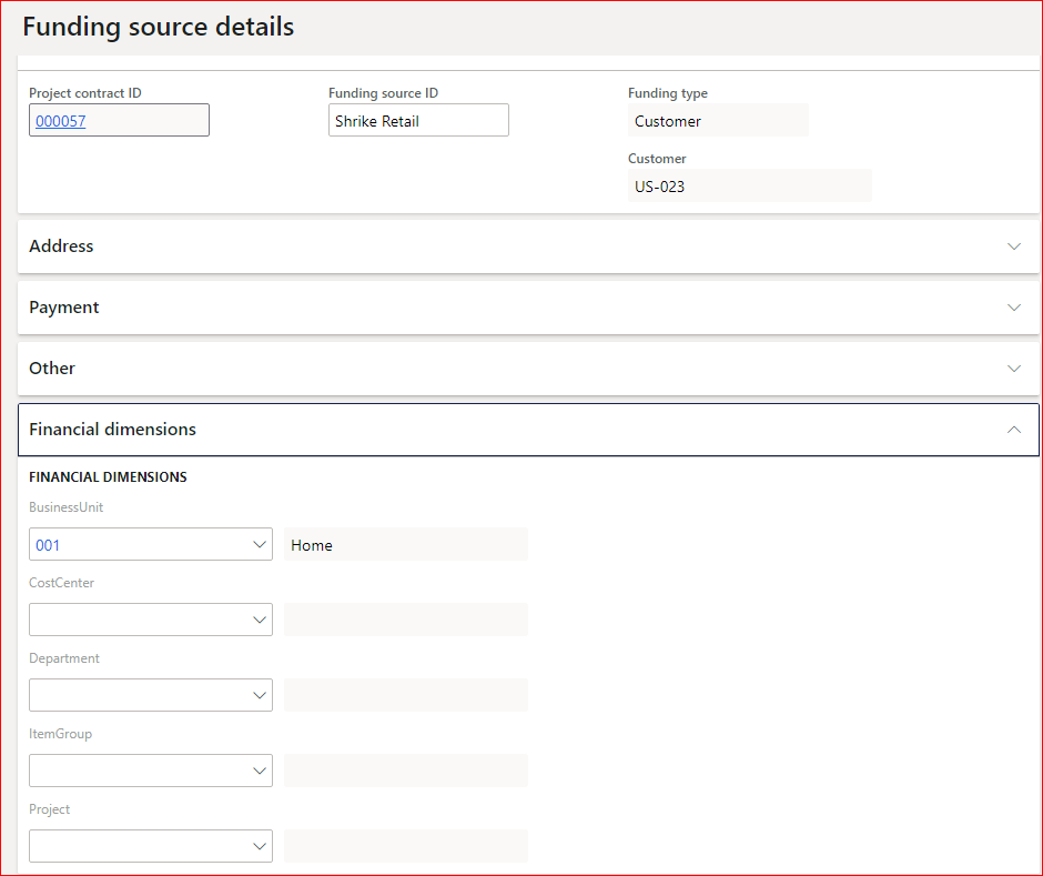

    • Dinabandhu Mohapatra
      February 11, 2020 at 8:26 AM
      Dear,
      could you defined financial Dimension on Contract ->Funding source Details for getting dimension at Summary Account.
      let us know if have any issue after this .
      Functional Lead -India
    • Tarun Godhwani
      February 11, 2020 at 10:39 AM
      HiĀ Dinabandhu,
      Thanks for sending the information. Yes, setting up the default dimensions on the Funding Source resolves the issue. I am now able to see the project dimension on the project invoice vouchers.
      Many thanks!
