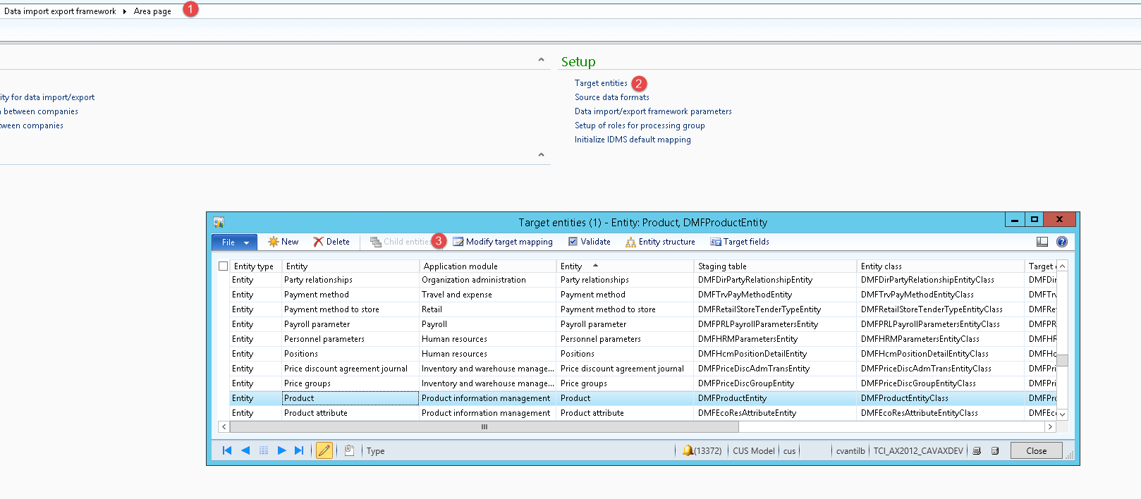

      You can modify the mapping to change this however:
      1. Got to the DIEF Area Page
      2. Open Target Mapping
      3.Modify Target Mapping
      1.Switch to Details View
      2.Select the mapping to remove
      3.Delete the mapping
      4.Save your changes
      Now you won’t update those fields which are removed.
      Hopefully this helps.Ā
