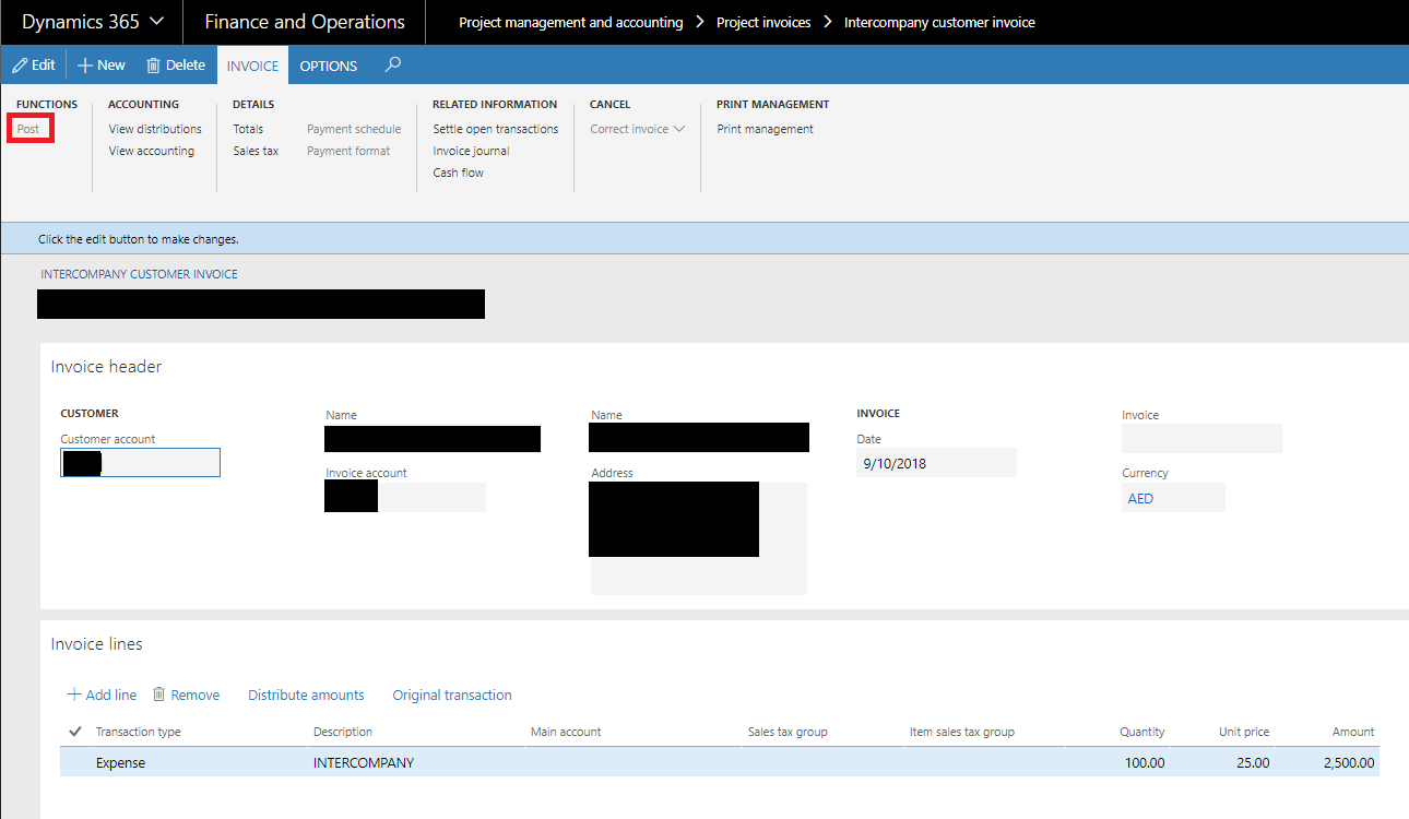

      We’ve run into an issue whereby when creating a Intercompany Customer invoice via the Project Management and accounting module (Project Management and accounting module > Project Invoices > Intercompany project invoice), we are unable to post the Invoice once the associated invoice lines have been added to the invoice. The post button is greyed out (see Red square). Does anyone know what we may be missing that is precluding us from posting. Intercompany accounting settings have been setup. There is a relationship defined between the Interco Customer and Interco Vendor.

      Can you check in the view distributions/view accounting forms whether some account setup might be missing?
      Is only your user affected by this issue or does everybody have the same problem?
      Have you compared this behavior in a different test/dev environment?

      The behaviour persists even if there is a complete account distribution. It is not user specific.
      Unfortunately, we don’t have a Contoso environment. The only difference that I was able to detect was the presence of a A/R free text invoice workflow, but that doesn’t mean I may have missed finding the proverbial needle in the haystack.
