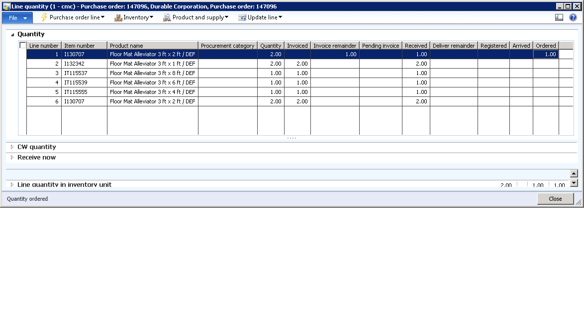

      I have a PO line in AX and I’m trying to figure out how I can cancel the “Ordered” quantity.  If you see the screen shot below it is showing 1.00 “Ordered”.

      We see this regularly, it seems to happen if the buyer reduces the order quantity after the PO line has been partially received in our case.  We’re 2012 R2 cu7.  Have you tried on the line level Update Line –> Deliver Remainder –> Cancel Quantity?  If you have like we have you may find that errors.  In that event what we’ve found is there is a hanging “Ordered” line in the InventTrans table.  As Administrator/DB I go through the AOT to the InventTrans table, find the “Ordered” transaction that is still there for the PO Line and I delete it (alt F9).  This won’t change the status of your line so if your line isn’t status “Invoiced”  you’ll need to address that as well.

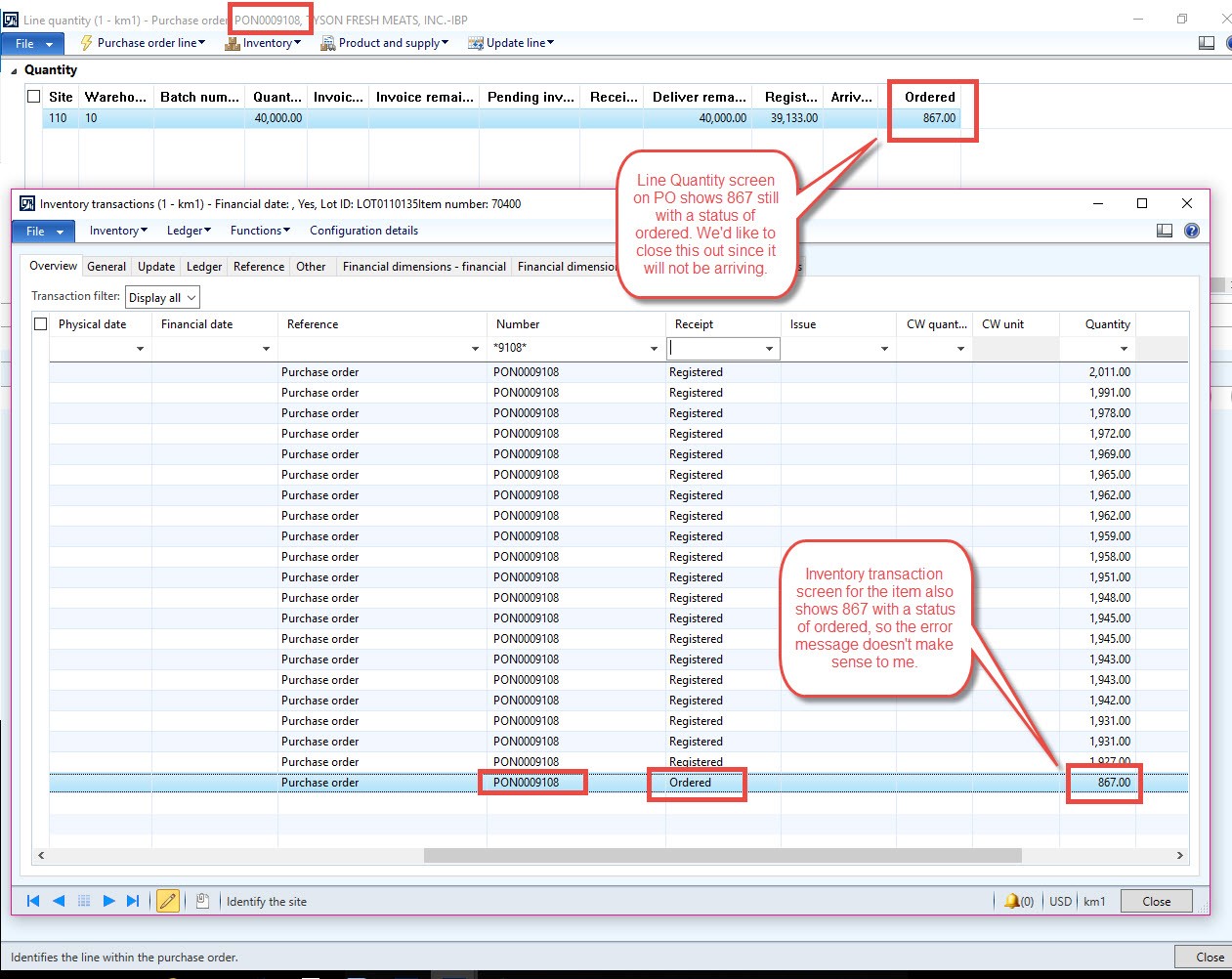

      We just upgraded from AX 2012 R3 CU8 to CU11 and we are unable to cancel the deliver remainder on a line, either by closing the line when posting the product receipt, or by choosing the option to update / cancel deliver remainder on the PO line. This appears to be a universal problem for us now any time a PO is delivered short. The buyers are not editing the POs, so I don’t think that’s what is causing the problem. Every time we try the transaction though we get the error message that “Quantity ordered cannot be reduced because there are not enough open inventory transactions with the ordered status.” I’ve looked at the inventory transactions for the item though, and it all looks to be in order. We didn’t have this problem before upgrading to CU11. Any ideas?

      There are two options to do what I believe you want, through the AX Client (and these work on both Sales Orders and Purchase Orders):
      1. Change the ‘Quantity’ on the line, in your scenario, from ‘2’ to ‘1’, and save the line, that will:
      2. Set the line to fully delivered
      3. Show 0 as qty still on order
      4. And make the line look like you first ordered 1 (and not 2)
      5. Use the function under ‘Update Line / Update / Deliver Remainder’:
      6. Select that line and choose as above
      7. Two options here:
      8.                                                                i.      Set field ‘Deliver remainder’, which has value 1 (1 still on order) to zero, then click OK
        or
                                                                     ii.      Click on ‘Cancel quantity’
      1. In your scenario, both of above options will have the same result:
                                                                     i.      The Quantity ordered will still show as 2
                                                                   ii.      But the PO Line status will again show fully delivered
                                                                 iii.      And show 0 as Qty still on order
      The main difference between the two options is what the field ‘Quantity’ shows… in option 1 it gets changed to 1, in option 2 it still shows 2 were ordered, one received and you won’t get the other remaining piece delivered.
