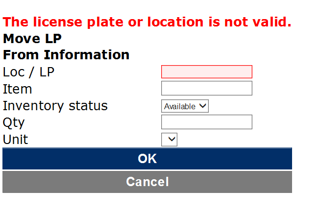

      ?We are using AX 2012 R3 CU9. I am trying to move inventory from one location to another and I get the following message.
      This location does not require license plates. We were able to move from that location the day before and now we can not. It is only for that location. On other locationsĀ I can make the move just fine.Ā  I can notĀ adjust inventory into or out of this bin. I can put away and pick inventory from this binĀ without any problems. Ā Does any one know what would cause this or how to fix it?

      I will put £1 on someone having created a License plate with the same name as the Location.
      Check in the License plates form (Warehouse management -> Setup -> Warehouse setup) if that ‘location’ exists there.

      ?Thank you. You are correct. I did find a license plate that matched the location. It was entered from a production order.Ā  I will check with my IT department to see about putting in the extra validation.Ā  Is there any way to fix this location?Ā  I have tried to delete the license plate and says there are open transactions.
