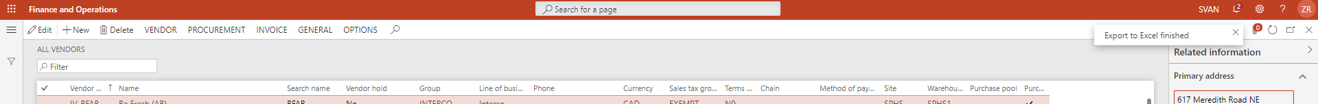

      For reasons beyond my comprehension, Microsoft seems to have introduced an “improvement” to the D365 v10 user interface where the menu path of the current form that used to show up at the top of the screen,Ā  is no longer visible
      So there it is no longer possible to quickly tell “where” a user is, when providing support / sharing screenshots etc.
      Is that behavior configurable somehow? do I have an option to reverse to the “old” (clearly technologically backward) design?

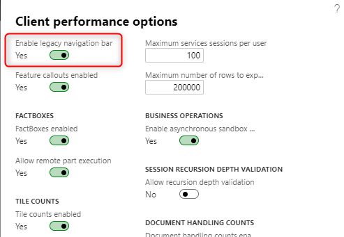

      To re-enable the navigation, go to System Administration > Setup > Client performance options and check the Enable legacy navigation bar box:Ā
      Microsoft claims this option will disappear completely in the future (I think in PU28), but hopefully that will change.

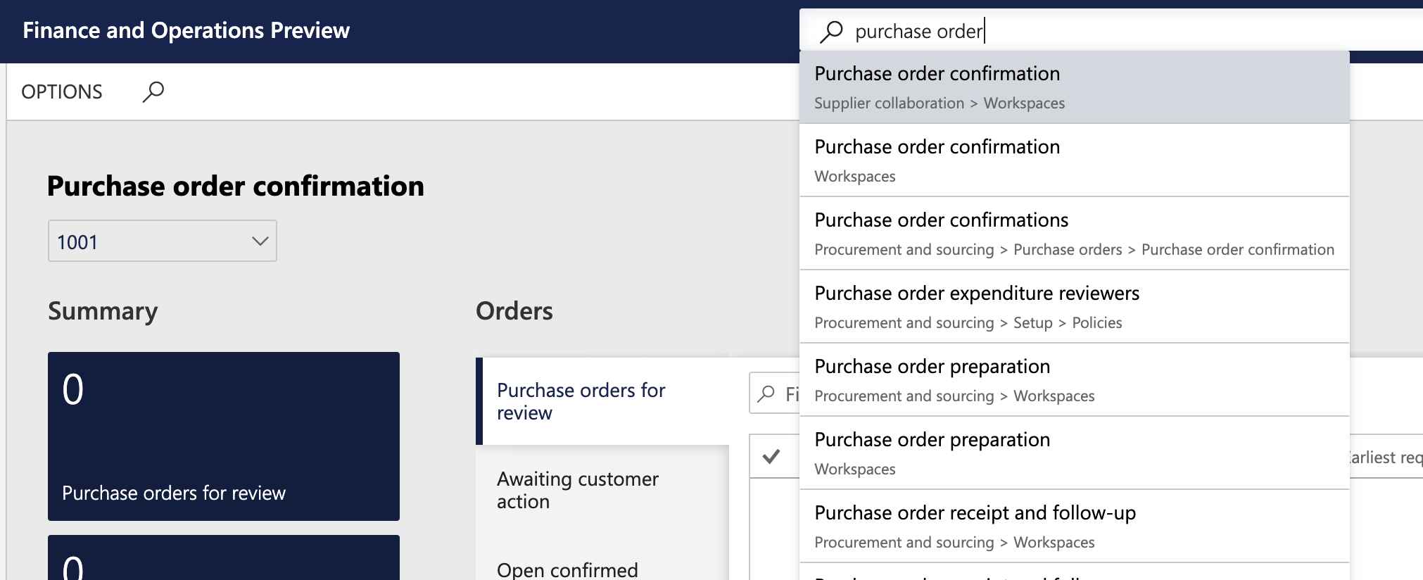

      Personal thinking on this is that the breadcrumbs are primarily being used by consultants and we should be pushing end users to be using workspaces more than they are. Hence MS has made the decision to unify the design and move to a consistent approach across the product set and make the search option provide the bread crumb and the link so you could find it the old way if you needed to.Ā  Remember the breadcrumb was not clickable so really it was only a sign post which is still available from the search option.
      This links in with the modern workplace theme and powerapps being able to be embedded on workspaces and forms.Ā  The D365 family and the ways of working in future could quite realistically see fewer people in F&O day to day and more in MS teams interacting to activities via CDS
      Image from 10.0.x

      My source is Microsoft’s PU24 update description:Ā https://docs.microsoft.com/en-us/dynamics365/unified-operations/fin-and-ops/get-started/whats-new-platform-update-24#updated-navigation-bar-that-aligns-with-the-office-headerĀ – specifically, this statement:Ā
      However, I see down below in the thread some indication this has been delayed until April 2020.

      Thanks Ben! that’s very useful, I completely miss the existence of this parameters form.
      Just to be sure before I change that in production – this setting – does it impact just MY account, or is that a global setting for ALL users?
      Is this is user specific, is there a way to mass-change it for users?
      Is there a way to make this the default for new users created?

      Microsoft intended to remove the legacy navigation bar in PU28. The most recent status is that they have postponed the deprecation.

      Zvika.Ā  It is a global setting per environment.Ā  Here is the announcement.Ā  It is going away Apr 2020.
