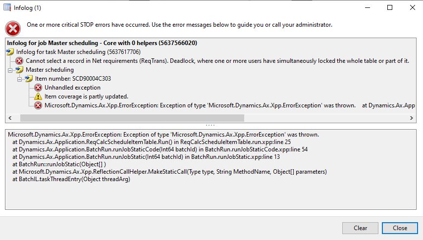

      Occasionally, I am getting the following error message from running Master scheduling which is run as a batch job during the night;
      Cannot select a record in Net requirements (ReqTrans).
      Deadlock, where one or more users have simultaneously locked the whole table or part of it.
      I was getting this error when I originally made use of 8 helpers, but reducing this to 0 seemed to resolve the issue, however it has begun to reoccur. There doesn’t appear to be an issue with the item setup as I can manually run master scheduling without error.
      Has anyone else encountered this issue and is there a workaround or a solution?
