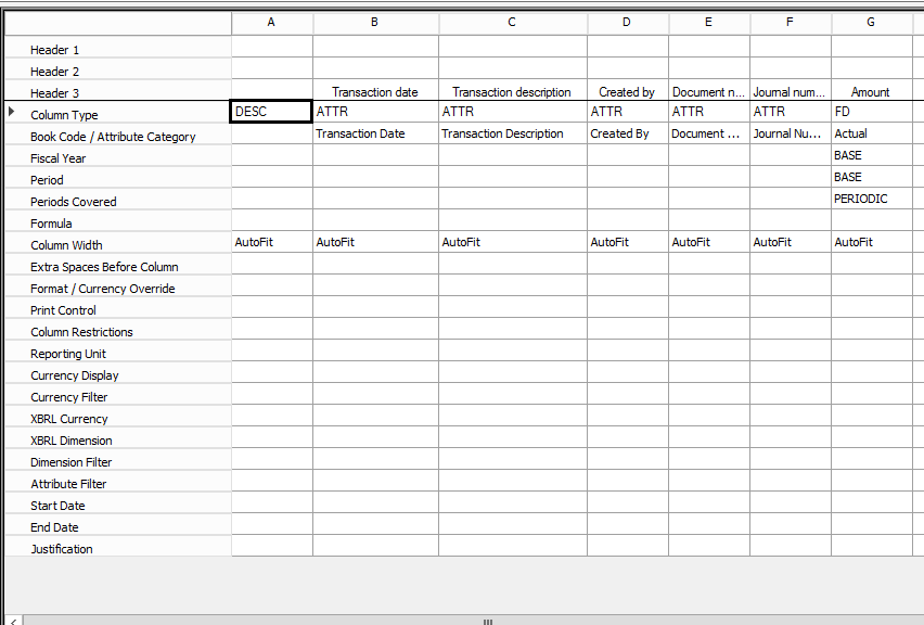

      Something else you could try.  If you change the detail level on your report definition to “Financial, Account, and Transaction,” and include some “ATTR” columns in your column definition, you can get a lot of the info you’re looking for from MR.
      MR column definition including ATTR columns

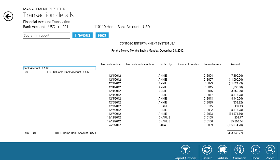

      Doing so, when you drill all the way down to the transactional level, will give you results that look similar to the following:
      Transactional details including attribute columns

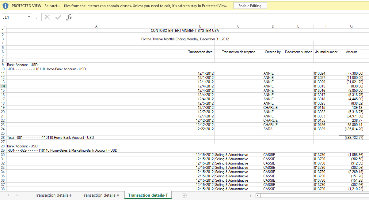

      I know it doesn’t get everything you want, but it might help a bit and allows you to keep this in MR instead of dumping it out to an Excel report.  You can also do that, if you want, from MR and at least have a consistent set of data to refer to.
      Excel export from MR showing attributes in transactional data

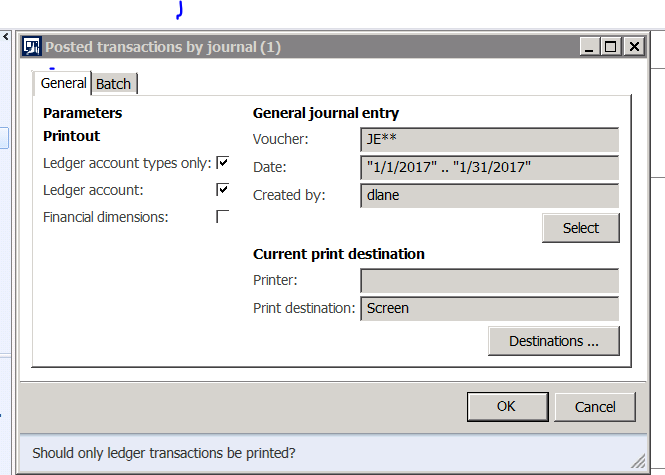

      Here is how I got the information.  General Ledger/Reports/ Journals/Posted Transactions by Journal and then entered the above critieria in my search.  Hope this helps.
