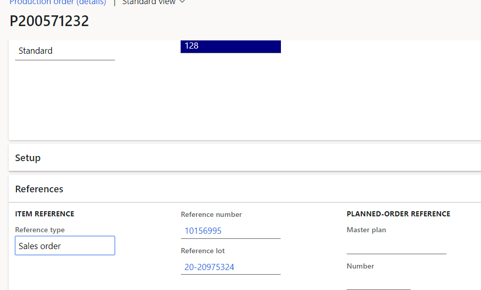

      We don’t know how to manage goods in the warehouse, when they are packaged for a specific sales order.Ā  Do you also face this issue and how do you cope with sales order picking?
      We make to order: production orders are linked to a specific sales order line.Ā  Packaging and labeling is done just after the production process.
      When production is finished, we store the goods until they are picked for shipping.Ā  But the goods being “anonymous”, they are not targeted by the picking work.
      Do you know of a way to tell the system “this has been produced towards a specific sales order.Ā  When picking for this sales order, come and pick them and not just any item with the same item number”.
      If you do, I’d be super grateful for you to explain the steps you follow in the production process (or is it on the sales order? Or both?).

      I might be wrong, cause I don’t get all the subtlety around marking and reservation, but creating a production order from a sales order would have the same result as firming a planned production order with marking?Ā  I already have a sales order referenced on the production order with my current way of working, if that is what you mean.Ā  Is it?
      you could reserve a specific batch or license plate to a sales order line to force fulfillment from that pallet” –> this is exactly what I’m after!Ā  I didn’t know about flexible reservation hierarchy.Ā  I’ve found some MS documentation and it looks very interesting.
      If you can give some extra details on how to use it that would be awesome.
