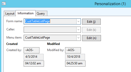

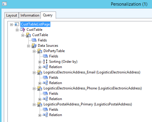

      To be able to reduce the number of people able to perform a task you first have to determine the objects that control access to that process. Do you know the menu item(s) and/or table(s) that specifically allow you to perform that task? Once these objects are determined you can review the users/roles/duties/privileges that can perform that task.
      One way to do this in AX 2012 is to go to the form personalization (right click on form -> Personalize) and see menu item and datasources are being used. For example, if I did this on the Customers form I can find the objects that control access to this form.
