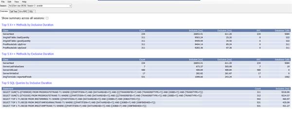

    • Andres Verdin
      August 21, 2019 at 12:36 PM
      Thank youĀ  for your replyĀ
      Looks like the table that is taking most of the time is prodroutetrans which has 400K recordsĀ  (about 300K for this company),Ā
      Trace results

    • Andres Verdin
      August 22, 2019 at 11:11 AM
      Yes I did (run statistics), I found the issue,Ā  the JmgJobTable has 2 display methods to show reportedĀ  QtyQrror and QtyGood for the same job/operation, the execution of those queries is what it taking all the time to process. That means two more queries to the table ProdRouteTrans per record on the JmgJobTable query.
      Queries on the display methods:
      return (select sum(QtyError) from prodRouteTrans
      where prodRouteTrans.TransRefId == this.ProdId &&
      prodRouteTrans.TransRefType == ProdTransRefType::Production &&
      prodRouteTrans.JobId == this.JobId &&
      prodRouteTrans.TransType == ProdRouteTransType::Qty).QtyError;
      return (select sum(QtyGood) from prodRouteTrans
      prodRouteTrans.TransType == ProdRouteTransType::Qty).QtyGood;
      Even do this form (job registration) does not use these fields (at least is what I saw) these fields are added to the Cache on the init method for the jmgjobtable datasource:
      jmgJobTable_DS.cacheAddMethod(tableMethodStr(JmgJobTable,badQuantity));
      jmgJobTable_DS.cacheAddMethod(tableMethodStr(JmgJobTable,goodQuantity));
      If I comment or deleteĀ  these 2 lines, the form will take no more than 5 seconds to load, but I’m not sure if that will create another issue, we are testing it right now.
