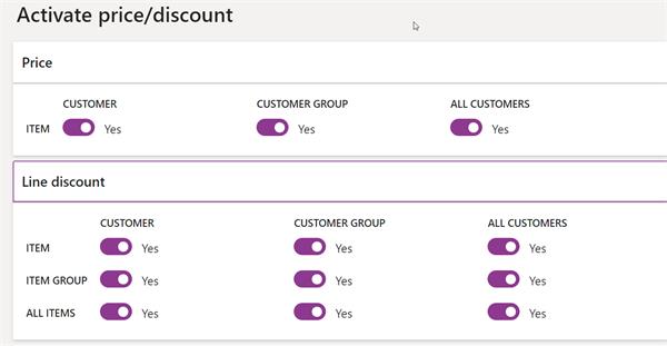

      I’m working on trade agreement and really miss something like a “item price group”.
      We can group items regarding line discount, but not regarding prices…
      I would love too though, because we have many items with the same price, and it would be great not to have to set a trade agreement for each.

      You are correct, there is no price group on the items, only discounts. I had been looking at a trade agreement journal and assumed there was one because it had the table/group/all dropdown :/

      We came up with a workaround. I wouldn’t warmly recommand you to go for it, but I believe it’s always worth sharing.
      We set a fixed price on each item, then use “line discount” on item groups to steer the price.
      So if we have a change in price for many items of the same group, we just have to change the discount on the item group.
      Then we hide this mecanism on the printouts.
      This is a workaround and has some drawbacks, as each time we divert a standard functionality. The worse one is that due to rounding up, sometimes the figure on the invoice don’t add up šŸ™
      Another one is that we can not use line discounts for what they are for.
      I’m still hoping for MS to bring a solution for that – and wonder why it’s not the case already.
