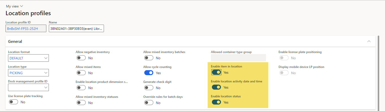

      1. The location status should tell you if your locations are empty, but I believe the status would be showing based on Physical Inventory qty, not Available Physical. Have you confirmed that the location profiles have these fields enabled?Ā
      – I have seen where the location status will show as Undetermined if only the ‘Enable location status’ flag is set to Yes, but enabling all 3 flags adjusted the location status to show Empty
      Here’s an example what I see in the locations module:

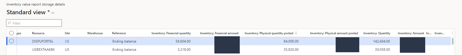

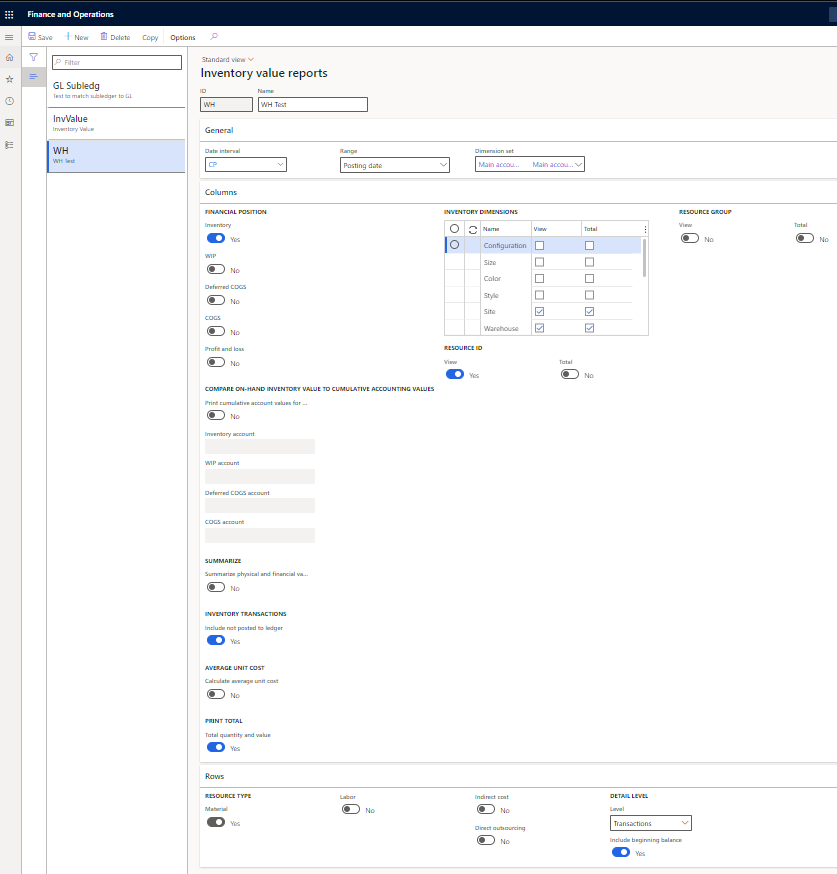

      2. You may want to check out the ‘Inventory value report storage’ feature, which does a decent job of summarizing. I read that these transactional reports once stored can be exported to external systems, but have not looked into how that is done.
      e.g.Ā
      Parameters used for the above report:
