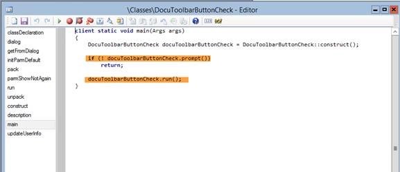

    • Angna Thakkar
      September 17, 2018 at 10:10 AM
      To prevent this Optimizing toolbar button dialog we can comment line no. 5 and 8 of main method in DocuToolbarButtonCheck class, so the dialog which is called from base class i.e. RunBase from which Ā DocuToolbarButtonCheck class is extended would not be executed as shown in below screenshot.

    • Rudy Salcedo
      September 18, 2018 at 9:27 AM
      ?Thanks Angna!
