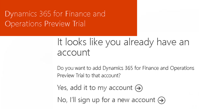

      Thanks to Andrew’s hard work and effort to help me resolve this, he found this link, which works!
      https://portal.microsoftonline.com/Signup/MainSignUp.aspx?OfferId=AA972CC1-91DB-4CF9-94A1-4A9163ED50C9&pc=2c50e379-9378-4761-84f9-e328da74e657&dl=ERP_INSTANCE_SKU
      In my case, following the link presented a page like this:
      I clicked on “Yes, add it to my account” and followed the prompts after that.

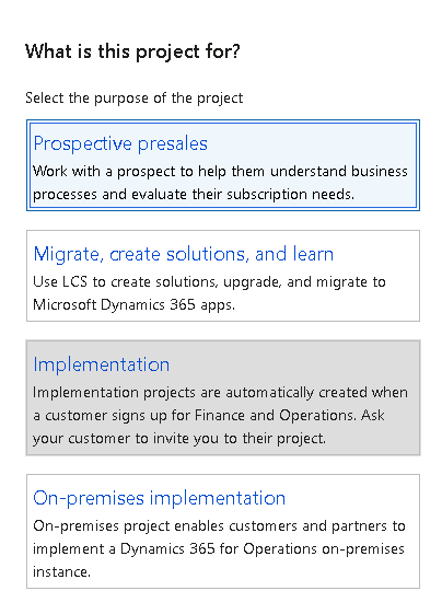

      No new project was created in LCS, but when I started a project I was prompted to select the type, which was different than before:
      I selected the “Migrate…” option, and now I can follow the rest of the steps in the Microsoft documentation for working on the upgrade and code analysis.
