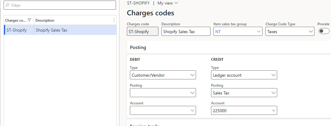

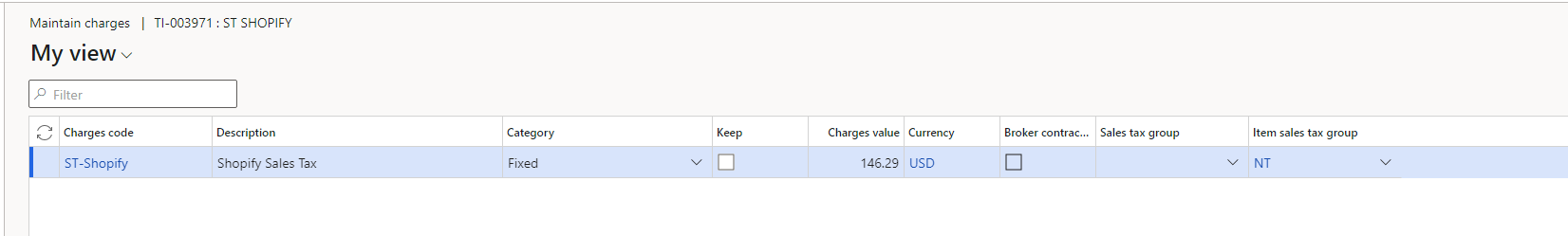

      Yes. We use Shopify and the order is passed to Dynamics via EDI. We do the following once the order is received in dynamics and ready to process:
      1. We create the order with a non-taxable sales tax group. We created one called EDI.Ā
      2. We take the sales tax from the EDI message and we create a charge on the sales order. We use a charge code that credits the correct sales tax ledger account and debits the customer accountĀ
        Charge code vvvvv
      This maintains the sales tax that was calculated and paid for within Shopify.
