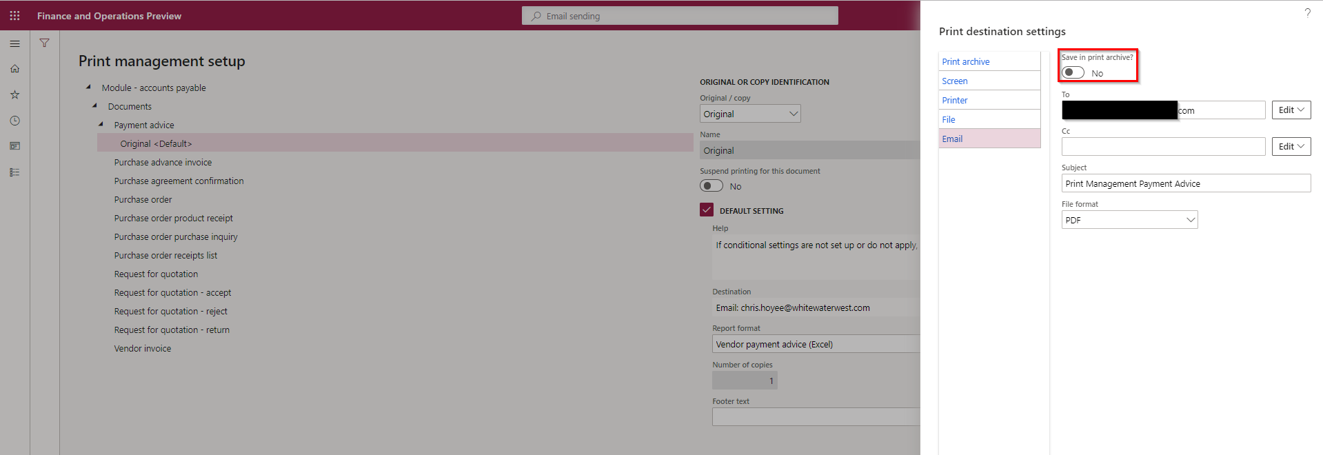

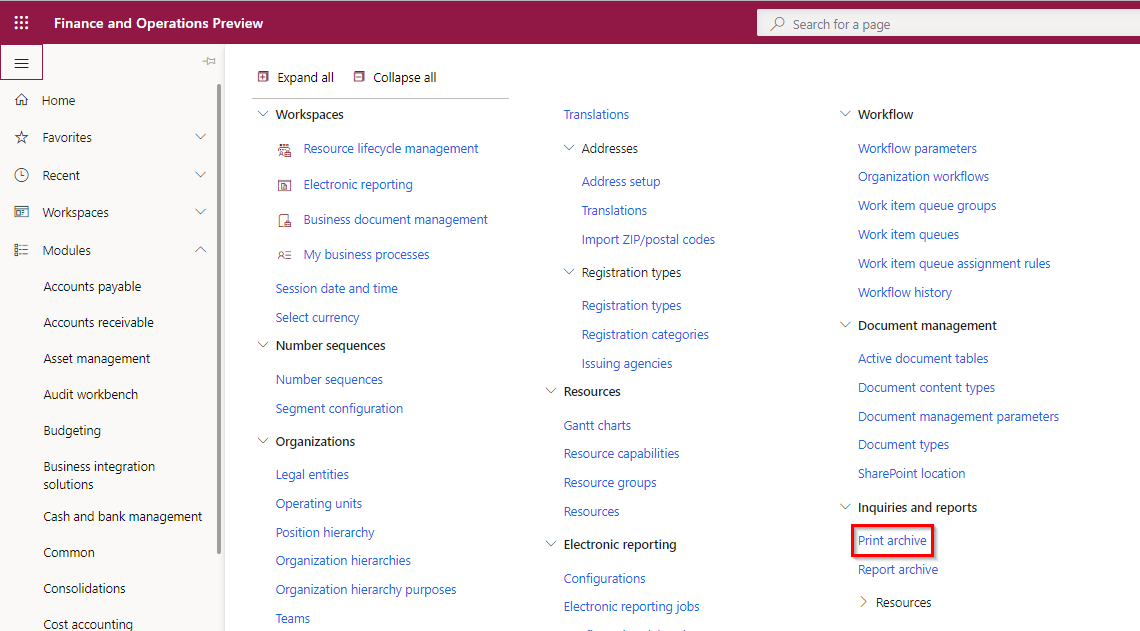

    • Christopher Ho Yee
      November 1, 2019 at 7:48 PM
      Hi Zvika,
      Have you tried toggling the Print Archive in Print management default setup?
      You can then retrieve the files from the Print archive (Organization administration > Inquiries and reports > Print archive)
      Still a clumsy option, but may be workable.

    • Zvika Rimalt
      November 2, 2019 at 7:37 AM
      Thanks Chris,
      Apparently we think alike since this is exactly what I ended up suggesting to the user as a workaround, and they thought it was workable.
      It’s an “OK” workaround, but I am not too crazy about it.
      All the files are created with the same name in the print archive list, and it can makes it harder for the user to located the one they want (some payment journals may have dozens if not hundreds of lines)
