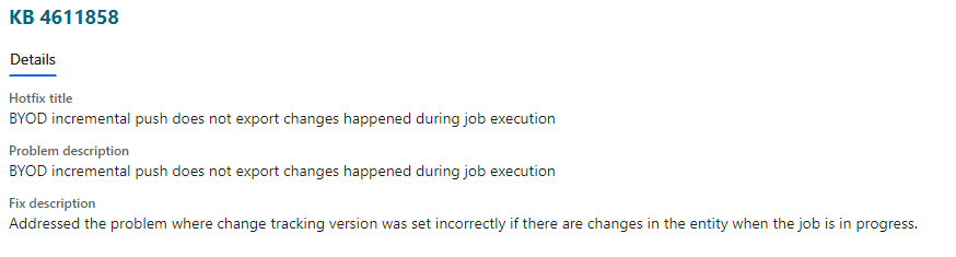

      September 15, 2021 at 11:28 AM
      Glad to help.  I don’t believe the change tracking type is the source of the issues we’ve seen.  Based on the evidence I’ve seen, it is more based on timing.  For example, many of our missing items were updated within a particular date range, which suggests there was some hiccup that occurred during that time.  Other missing items may have been similar, and doing a periodic ‘full’ refresh waylays those types of issues.  It appears there was also an issue within the change tracking system itself as identified in KB 4611858:
      This is available for version 10.0.20 and I’m working on installing it now but will probably leave the periodic full exports in place anyway just for safety.
