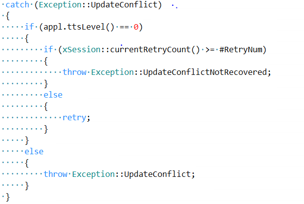

      Hi Rudy,
      This is common issue with processes executing in batch jobs. Is this batch invoicing orders asynchronously? this occurs when multiple threads trying to update the same record. You can try ‘retry’ mechanism in catch. It will retry the same operation in case update conflict occurs.
