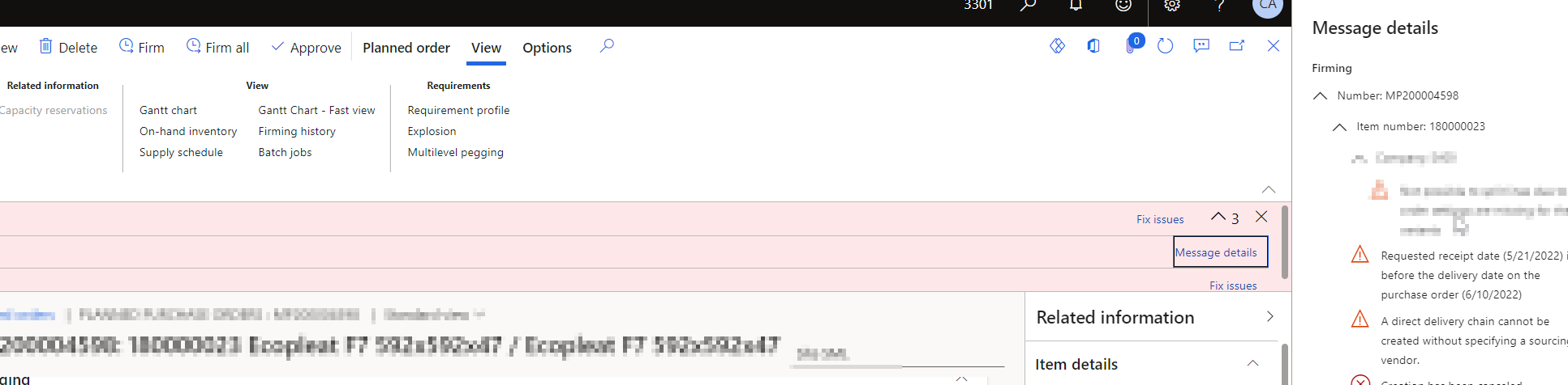

      I’m trying to get the MRP to create all purchase orders, whereas they are Direct Delivery or not.
      So far I didn’t find how to – when trying to firm the planned purchase order, I get an error message “A direct delivery chain cannot be created without specifying a sourcing vendor”.
      As far as I know, sourcing vendor can be added on the sales order line, but then the purchase order is created instantly and that’s not what I want – I want all purchase orders to be created by firming a planned purchase order.
      Has any of you the same considerations?
      Any feedback is more than welcome!
      Thank you by advance.
      PS: my example is for an intercompany purchase order

      Yes, the default vendor is filled.Ā  If flows to the planned purchase order.Ā  I have the “sourcing vendor” message in spite of that.
