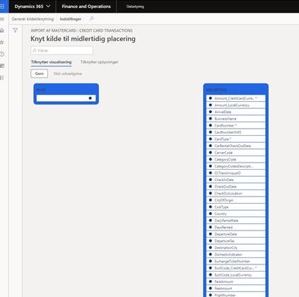

      I have been tasked with setting up a data import and map the source to staging, but the source file I have received does not contain any headings I can use to reference the entity.
      I hope the one of you can help answer my question.Ā
      Is it possible to do a mapping without the headings as references?
      I have attached an image of my dilemma.

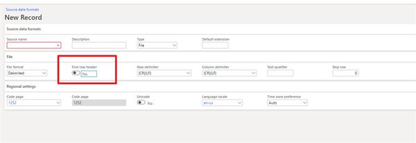

      You should be able to do that if you set the ‘First row header’ to ‘No’ on your source data format.

      November 27, 2019 at 9:41 AM
      Thank you for the quick answer, it was exactly what I was looking for. šŸ™‚Ā ?
