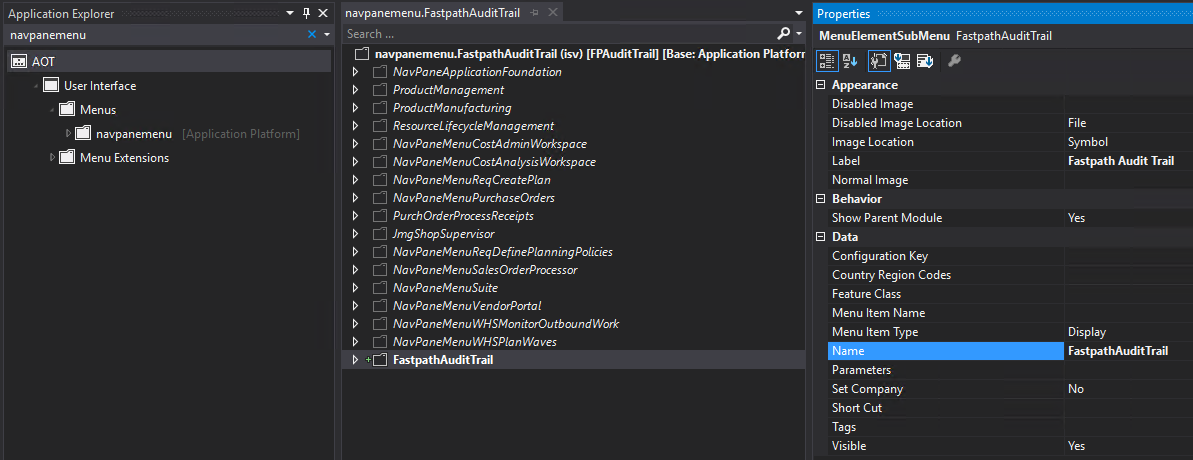

      Did you create an extension to the navpanemenu object and create a new MenuElementSubMenu object?
      Do you have the Menu Item Type and Name parameters on this MenuElementSubMenu associated to your created workspace element?
      Is the Visible property of this object set to Yes?
      Here is an example of how to set it up:
