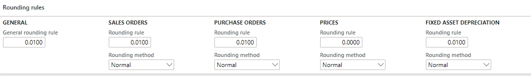

      Second, there’s no default way to force D365 to round GL postings to 2 decimal places across the board. So, when you go to 4 decimal places for pricing and costing, by default it will want to post GL transactions associated with inventory, sales and purchases to 4 decimal places. We definitely didn’t want that. The solution we found was to set the rounding on the USD currency to 2 decimal places for everything but prices. See screenshot from the currency setup:
      That has worked and kept all of our GL postings properly rounded to 2 decimal places. The setup has to be done for each legal entity and currency you deal with, but once it’s done, you should be good to go.
