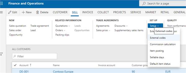

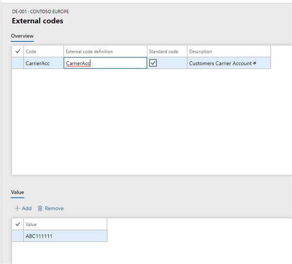

    • Colby Gallagher
      July 16, 2019 at 9:42 AM
      Hi Chris,Ā
      Ā  You can define your own fields off the customer record that can be used for all customers to store this information.Ā Ā
      Go to the customer master -> Sell tab in ribbon -> Setup field group -> Setup -> External Codes
      At the top of the form that opens, create a Code.Ā  Tick the “Standard Code”, so you can re-use this on other customers.Ā  Add the customers carrier account number at the bottom.Ā
      To get this to show on the Sales Order headers, you’ll need a small mod to join the ExtCodeTable into the SalesTableListPage query, then you can just personalize it in.
