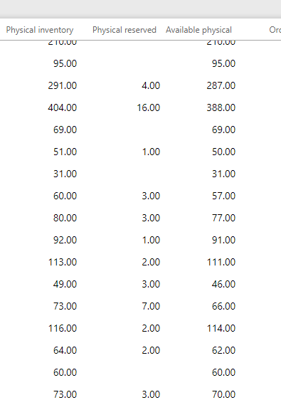

      Hi, we are new to D365 F & O – we have learned that we cannot post a cycle count journal until the retail side has posted their batches for the day. When we create a cycle count journal it’s based off of the physical inventory, rather than the available physical, so until our retail staff post the sales from the day before we can not create a cycle journal or post a cycle count because if we have the inventory locked the retail folks cannot post the days sales and until the days sales are posted we can’t cycle count. Everything is in the physical reserved until sales batches are posted. Is there another way to do a cycle count without inventory and retail crossing over each other? Any help or insight would be greatly appreciated. Thanks,

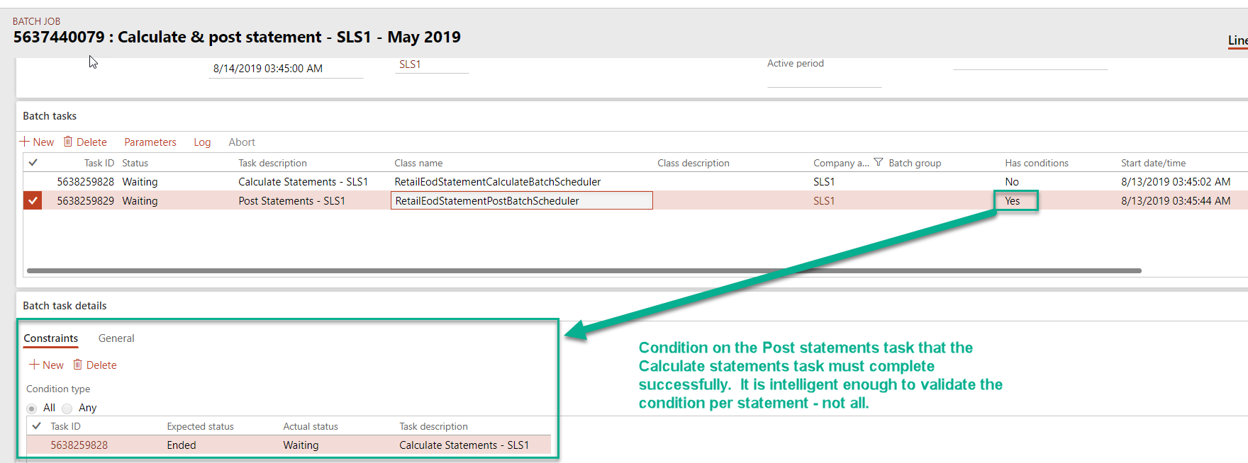

      In addition to the P-0001 job and the statement calculation and posting, you will also need to set up the “Post inventory” job and the “Validate store transactions” (if running version 8.1.3 or greater) job.
      We run the jobs in this fashion:
      1. P-0001 – Runs every 10 minutes
      2. Post inventory – Runs every 10 minutes; staggered with the P-0001 job
      3. Validate store transactions – Runs every hour
      4. Calculate and post statements – A single job that runs at 3:45 a.m. daily.Ā  We have combined these into one batch so that all statements attempt to calculate and then post. If a statement does not calculate successfully then it will not post, however all others will.Ā  Below is a screenshot.
      Calculate & Post statements batch
