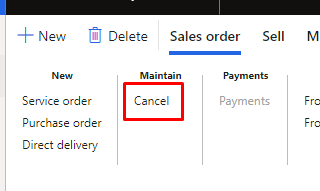

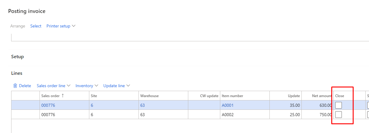

      This is “fill & kill” in my experience.Ā  The SO has 10 lines, you can fully / partially release 9 of them.Ā  You pick as much as you can for all 9 lines, then when you post the packing slip update or invoice update, you tick the “Close” box on the lines.Ā  This will cancel the delivery remainder on any of the 9 SO lines that you are updating.Ā Ā
      Since 1 line didn’t release to warehouse, you need to click the “Cancel” button against the SO header, and it will cancel all lines not yet released to warehouse.Ā Ā
      Alternatively, you can skip the “Close” checkbox process on the lines, run your invoice update, and then click the “Cancel” button from the SO header to cancel the delivery remainder on the 9 lines and the 1 line that never released. In order to do that, you need to make sure any short pick exceptions on the mobile device are flagged to reduce the load line qty.Ā  Ā  Ā If you go this route, you’ll want some type of sales pool / flag on the SO header and appropriate selection criteria to figure out what to cancel.Ā  Ā  You can do the cancel in mass / against multiple SO’s at once.Ā
