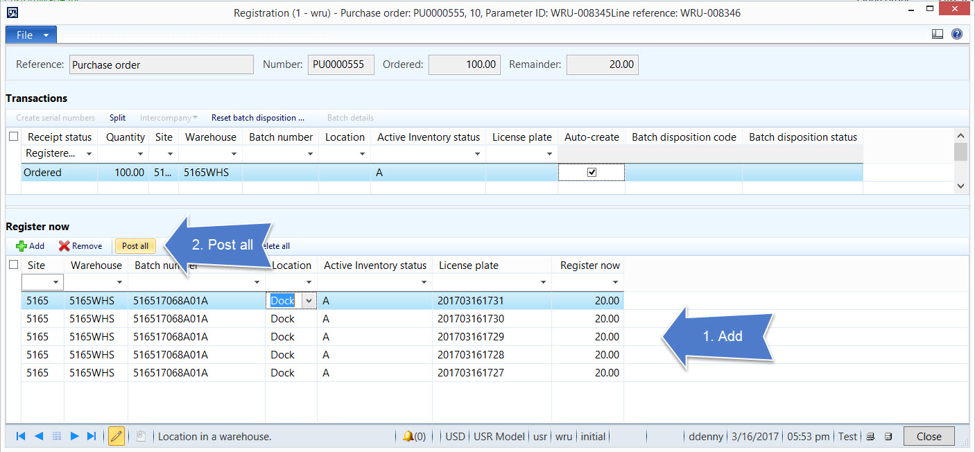

      There are many places within Dynamics AX 2012 R3 where I would like to auto-generate and print a thermal label and a 8×14 laser report when I perform specific function without using a mobile device. For instance, the last step in the Product Receipt process is the selecting of “Post all” to put the product into inventory. I would like to set up a trigger to auto-generate and print a license plate label (thermal printer) and a 8×14 pallet tag (laser printer) for each pallet the receiving clerk registers.
      Does such a trigger exist “Out of the Box” in Dynamics AX 2012 R3 or does this require custom programming?
