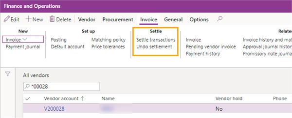

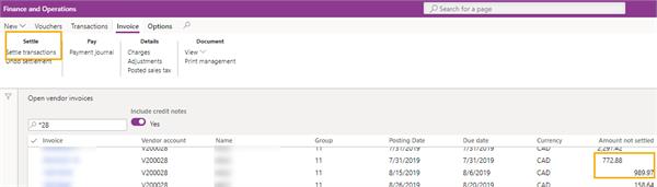

    • Mariana Ardito Couto
      May 26, 2020 at 11:14 AM
      Hi Kobe,
      No, this will avoid the credit from showing up on the payment proposal.
      To apply invoices against the credit, there are a couple different options, among them:
      1- Before generating a payment journal, go to the Open vendor invoices form, change the Include credit notes toggle to yes, sort/ filter by the vendor, and select Settle transactions.Ā Once all invoices are settled against the credit, you can generate a payment for the remaining amounts, as needed.Ā
      2 – Before generating a payment journal, go to the All vendors form, find the vendor, and select Settle transactions in the Invoice tab.Ā
