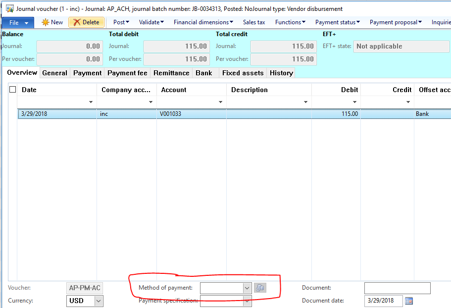

      ?Yes we are using payment proposal. I was able to successfully grab invoices when I filter on vendorĀ MOP like check (or ACH). However, I was unable to pay the invoice without the MOP filled in (see below).Ā  It would be great if the MOP field was updated with the default vendorĀ MOP when creating a payment proposal.Ā  That doesn’t seem to be the case.
      Once I manually update the MOP field in the payable journal, I can process payment.
      This is an example of what is returned when I request to pay invoices for vendors with a MOP of ACH.Ā  I get the results. But unless I update the red box, I can’t actually pay this invoice.Ā
      Is this standard functionality?Ā

      ?Great. So in the payment proposal, before you transfer it to the journal to create the payment journal lines – you can update the MOP on the invoices (top pane of payment proposal).
      There’s a button there that let’s you do a mass update so if you’re paying 60 invoices with 1 check, you can update all 60 invoices’ MOP in 1 shot.
      This is the standard functionality.
      If you have a good team or partner, this likely could be a small development itemĀ for themĀ to update theĀ applicationĀ so when you transfer the lines to the journal, it sets the MOP for the lines based on the vendor account.
