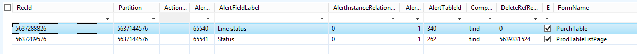

      So for example, if you are putting an Alert on a device,Ā  then the Alert rule will be againstĀ Data DictionaryTablesAMDeviceTable.Ā  Ā First, check the EventRule table to ensure your rule shows up.Ā  It will like something like this:

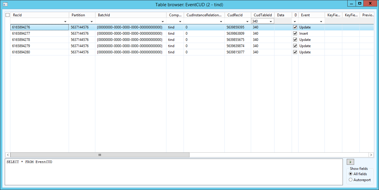

      Note the AlertTableId,Ā  Ā that same ID should be written into the eventCUD table in the CudTableID each time it is altered.Ā  Ā Make sure that those eventCUD records are being created.Ā  Ā You will need to look in the EventCUD beforeĀ ClassesEventJobCUD(Change based Alert Batch) runs next.Ā  Ā Ā
      It should look like this:
      If the eventCUD is not being created then we would need to look at customizations around the Device Table or form.

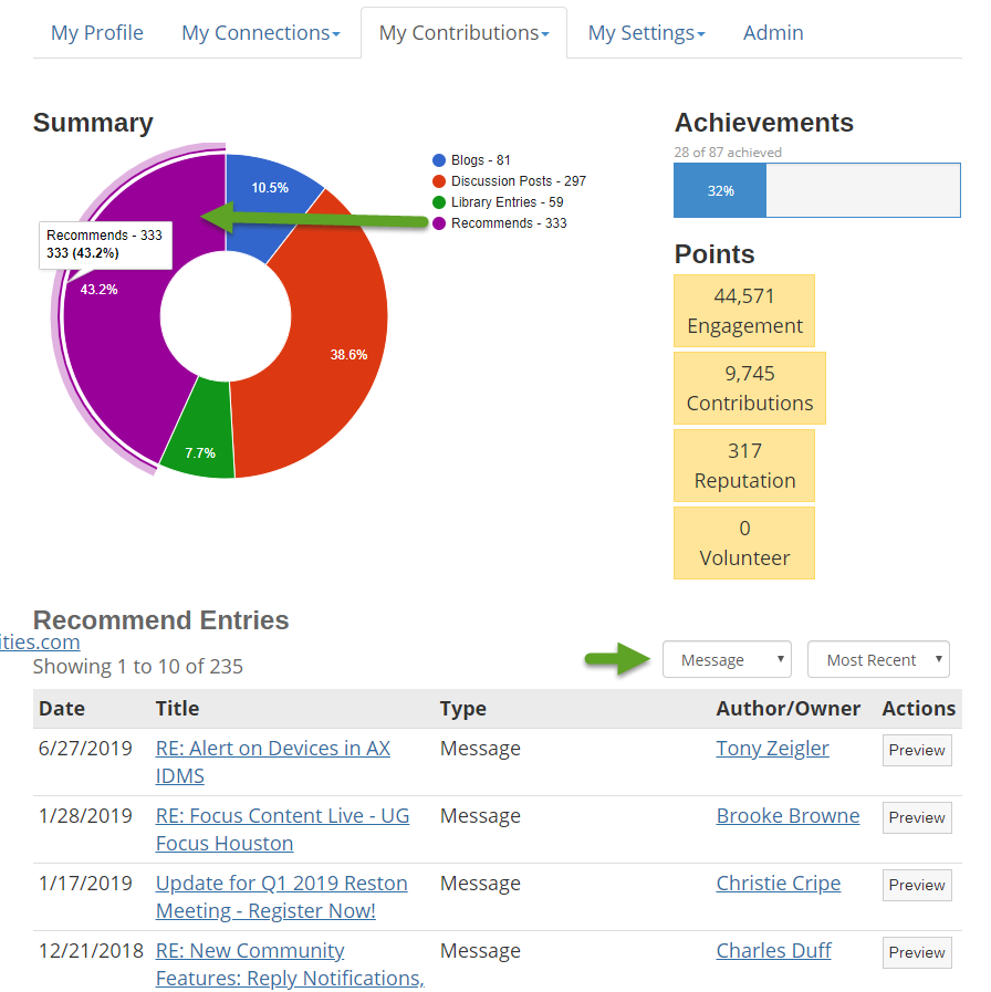

      One way to keep track of posts like this is to ‘Like’ or recommend them.Ā  Then to access your recommended/liked posts, you can visit My Profile > My Contributions > Summary.Ā  Click on the Recommends section of the wheel, and content that you’ve Liked will appear below.Ā  Choose Message in the filter option, and you’ll see posts sorted by date.Ā Ā
      My Liked content
      There also continues to be platform development work to make it easier for users to track content of interest.Ā  Hope this helps for now!
