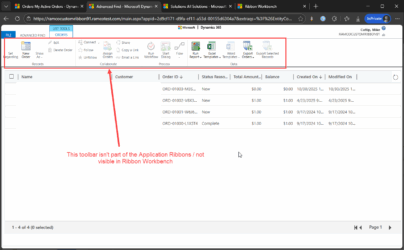

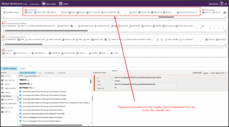

    This is an odd one so I’m hoping the experts here can help. I’ve been modifying my 9.1 on-premise ribbons and don’t see where the Advanced Find *results* ribbons actually lives in the Ribbon Workbench UI.
    For example, I’ve loaded my Application Ribbons into a solution and opened it in the workbench. There’s a section in the Home for Mscrm.AdvancedFind, and that controls the buttons available when creating an Advanced Find, but I can’t find a section for the buttons when displaying advanced find results. See attached for what I mean.
    Does that exist? Is there a way to separately edit the buttons available when viewing the *results* of an Advanced Find?
    Ultimately I’m trying to add the “Send Direct Email” button back to my Advanced Find results page. That function is available on the UCI, but not on the classic Adv Find UI.
